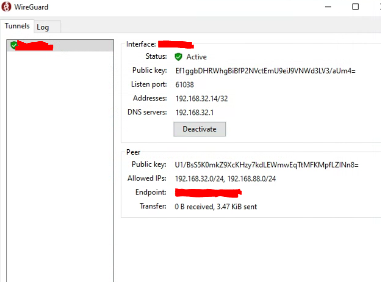

However I followed this and it won’t work. Also when I click activate on my remote PC I lose internet connection which is not good either.

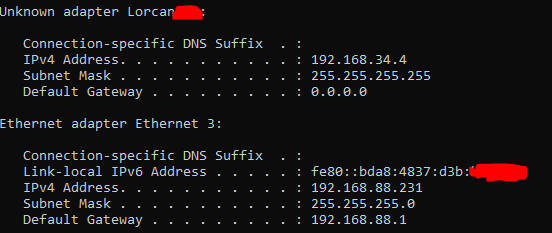

I have attached a picture of my ipconfig. For some reason the 192.168.34.1 wireguard network does not have a gateway assigned. I would have thought it should say 192.168.34.1 as the gateway?

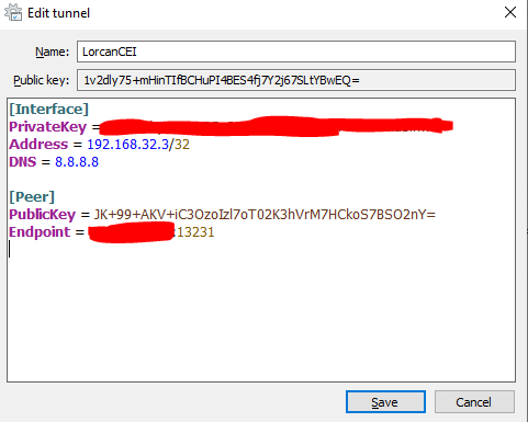

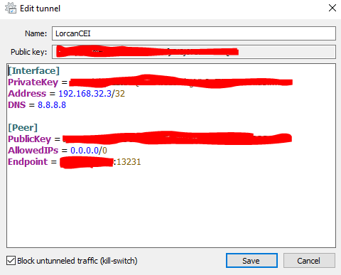

EDIT: Also, this is my wireguard config incase it matters
Can you also show config from the other side ?
Especially the wireguard part.
I am not 100% sure what you mean but I assume you mean the wireguard windows client info. I have attached it incase that is what you mean. Thank you
Assumptions (since it is not shown):
  • Public key of Mikrotik peer = public key shown on top of PC client - please confirm
  • Public key of PC peer = public key used on Mikrotik Wireguard interface - please confirm
If both are correct, do you see packets flowing in status of peer (both TX and RX should move) ?

Here is the info attached.
Also, just to say. I removed from the original wireguard windows config the line “AllowedIPs = 0.0.0.0/0”
This has turned ipconfig to say:
Unknown adapter LorcanCEI:
Connection-specific DNS Suffix . :
IPv4 Address. . . . . . . . . . . : 192.168.32.3
Subnet Mask . . . . . . . . . . . : 255.255.255.255
Default Gateway . . . . . . . . . :
I am now able to access the internet and ping 192.168.32.1. However I am not currently on a remote PC to test it properly but it might be the problem?

On the remote PC, I still can’t even ping the IP of the Wireguard (192.168.32.1), nevermind see the server on File explorer.
On my local PC, I am able to ping 192.168.32.1 and 192.168.88.1, etc. I can see the file server on file explorer but thats probably through 192.168.88.1 not 192.168.32.1
I will look back through this thread and see if I am missing any firewall rules. Is the set up more complicated for a remote PC (external to my LAN) to access the local network… I am pretty sure the set up I followed in the youtube video was for this exact use case so it probably should be working
Edit: I have added a picture of wireguard setup on remote PC and my code for mikrotik:

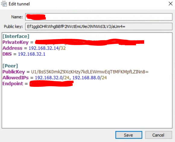

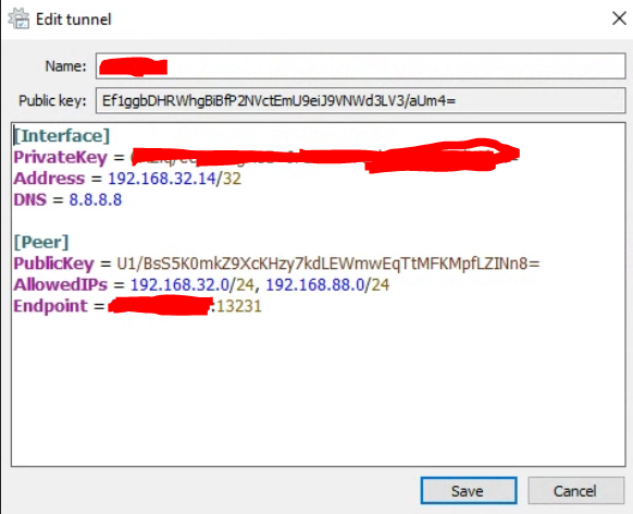

Thank you for your help
please post complete config of MT wireguard server device
/export (minus serial number and any public WANIP info)
And the settings on the remote device you are using.
Also confirm from the remote device that you can ping the MT on the normal WAN side (before attempting a tunnel).
I have attached a picture of the Wireguard config on the remote device.
Also code is below.
“Also confirm from the remote device that you can ping the MT on the normal WAN side (before attempting a tunnel).”
I believe from this you mean to ping my public IP, without being activated on Wireguard. In command prompt on remote device when I ping the public IP I get a reply.
(1) On your Mt router input chain rule modify.
From
add action=accept chain=input dst-port=13231 in-interface=ether1 protocol=udp
TO:
EITHER
add action=accept chain=input dst-port=13231 in-interface-list=WAN protocol=udp
OR
add action=accept chain=input dst-port=13231 in-interface=pppoe-out2 protocol=udp
(2) For Client device DNS setting put in 192.168.32.1
(3) While your at it and assuming all the WAN client stuff for pppoe is done in the PPPOE settings you should remove this.
/ip dhcp-client
add comment=defconf interface=ether1
(3) Disable or get rid of this rule…
add action=src-nat chain=srcnat ipsec-policy=out,none out-interface=ether1
to-addresses=XX.XX.XX.XX
It seems that I am now able to get ‘Sent’ data on the Wireguard remote PC client. I have attached the setup and then an overview which shows traffic data.
As you can see it says ‘Transfer: 0B Received, 3.47 KiB sent’ previously both of these were zero. However in Mikrotik → wireguard → Peers → Both peers set up say 0 KB Tx and Rx. The Mikrotik-Wireguard interface in Mikrotik → Interfaces → Interface list also has no Tx or Rx data sent (i.e. it is zero)
So the data seems to be getting sent somewhere but not Wireguard interface?
Just to note I can’t see the NAS on File explorer, or any other devices on the network and I can’t ping 192.168.32.1 (Request timed out)
