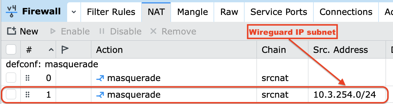

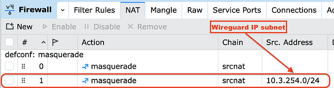

Figured out what the issue was, all the tutorials leave out the NAT firewall rule.
How how does someone make a tutorial and leave out important parts. Here is the Nat firewall rule.

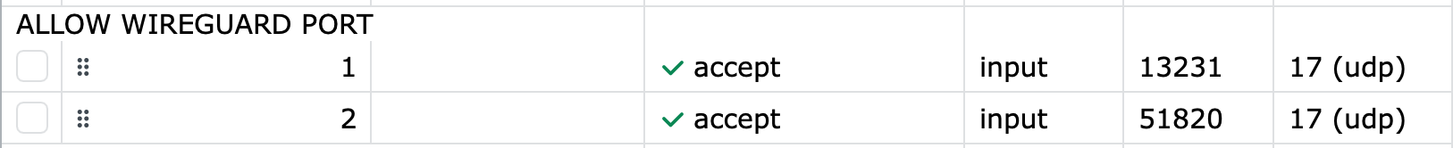

FWIW you don't need an IP address pool defined for Wireguard (each peer is assigned manually). And you shouldn't need a separate masquerade rule for you to access your router and home network resources via Wireguard through the router. If you add the Wireguard adapter to the LAN interface list used by the default firewall it will be treated in many respects like wired and wifi clients.
If you post your configuration you can get some feedback on what you have now, in case it can be improved.
@cpunk was faster, but yes, there is no need for separate masq. rule for WG and there is no need for separate IP pool. Also why two firewall rules ? Do you have two WG interfaces ?
You should post your configuration so we can see what you did and help you to do it the right way.
