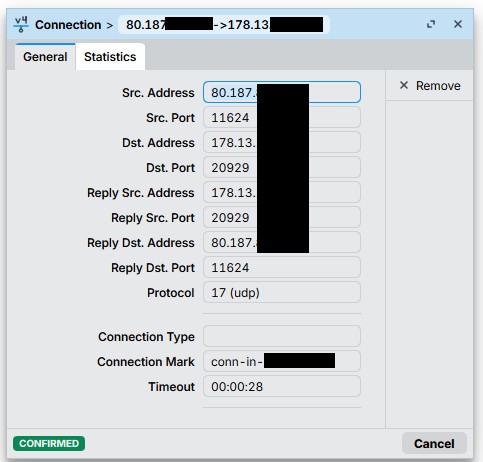

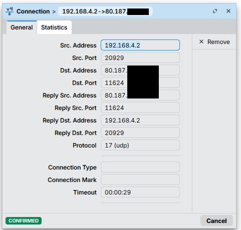

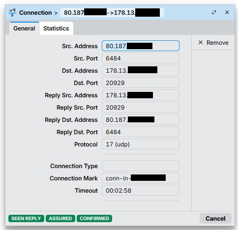

Working with routing rules:
Broken (with Mangling):
in
out (lowest distance default route in main table)
