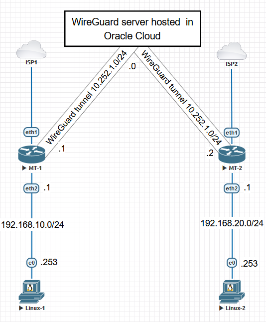

Hi to all, first time posting here.
Apologies if I am not using the correct terminology, I am not network specialist.
I am trying to connect Linux-1 and Linux-2 hosts subnets using 2 Mikrotik routers MT-1 and MT-2. For the moment I am testing in Eve Ng with the following network diagram:
The idea is to create a transparent link between 192.168.10.0/24 and 192.168.20.0/24 subnets
Wireguard server is running on Oracle Cloud as a Docker container using wiregard-ui → https://hub.docker.com/r/ngoduykhanh/wireguard-ui

Any idea why Linux1 and Linux-2 cannot ping each other?
Many thanks in advance.

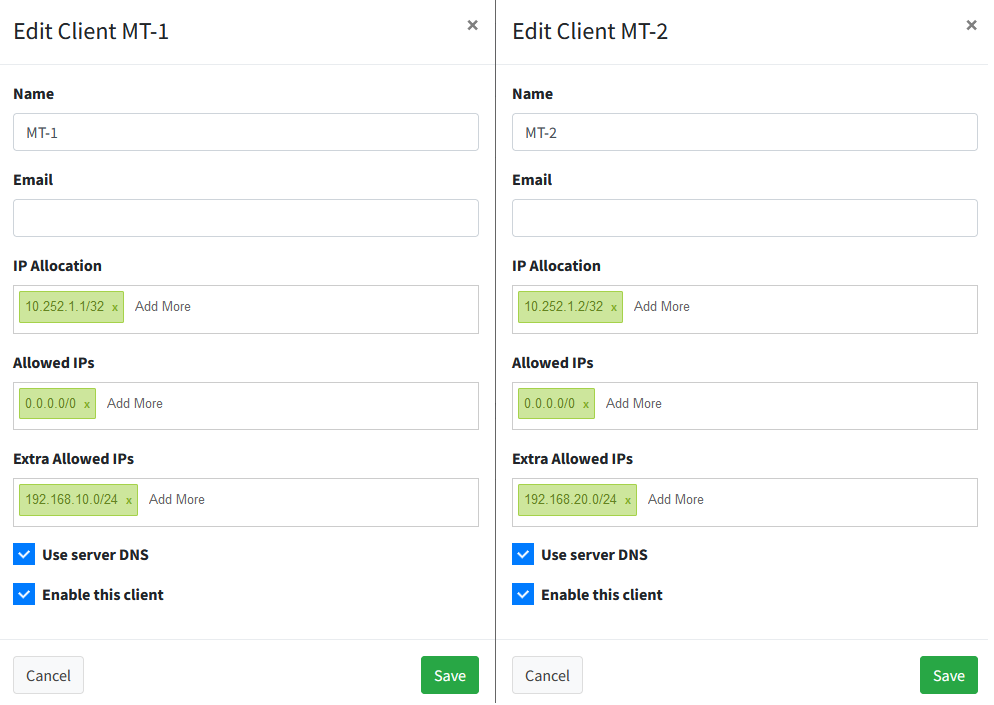

Check allowed IPs on server side for both peers.
Thanks for the tip holvoetn.
That was nicely done through the wireguard-ui “Extra Allowed IPs” field:
I simply had to add the subnet behind the corresponding peer and the resulting wg0.conf file was:
# This file was generated using wireguard-ui (https://github.com/ngoduykhanh/wireguard-ui)
# Please don't modify it manually, otherwise your change might get replaced.
# Address updated at:     2023-06-15 21:24:59.045081827 +0000 UTC
# Private Key updated at: 2023-06-14 20:39:03.464017656 +0000 UTC
[Interface]
Address = 10.252.1.0/24
ListenPort = 51231
PrivateKey = serverPrivateKey
MTU = 1450
PostUp = iptables -A FORWARD -i wg0 -j ACCEPT; iptables -t nat -A POSTROUTING -o eth0 -j MASQUERADE
PostDown = iptables -D FORWARD -i wg0 -j ACCEPT; iptables -t nat -D POSTROUTING -o eth0 -j MASQUERADE
Table = auto
# ID:           ci52hlgh0c8s70jsg44g
# Name:         MT-1
# Email:
# Created at:   2023-06-14 20:53:42.224575904 +0000 UTC
# Update at:    2023-06-14 21:15:14.752835761 +0000 UTC
[Peer]
PublicKey = MT-1_PublicKey
PresharedKey = MT-1_PresharedKey
AllowedIPs = 10.252.1.1/32,192.168.10.0/24
# ID:           ci52hugh0c8s70jsg450
# Name:         MT-2
# Email:
# Created at:   2023-06-14 20:54:18.250994141 +0000 UTC
# Update at:    2023-06-14 21:15:22.648545431 +0000 UTC
[Peer]
PublicKey = MT-2_PublicKey
PresharedKey = MT-2_PresharedKey
AllowedIPs = 10.252.1.2/32,192.168.20.0/24
2 new routes were automatically added to the server (I guess added by wireguard-ui? not sure…):
