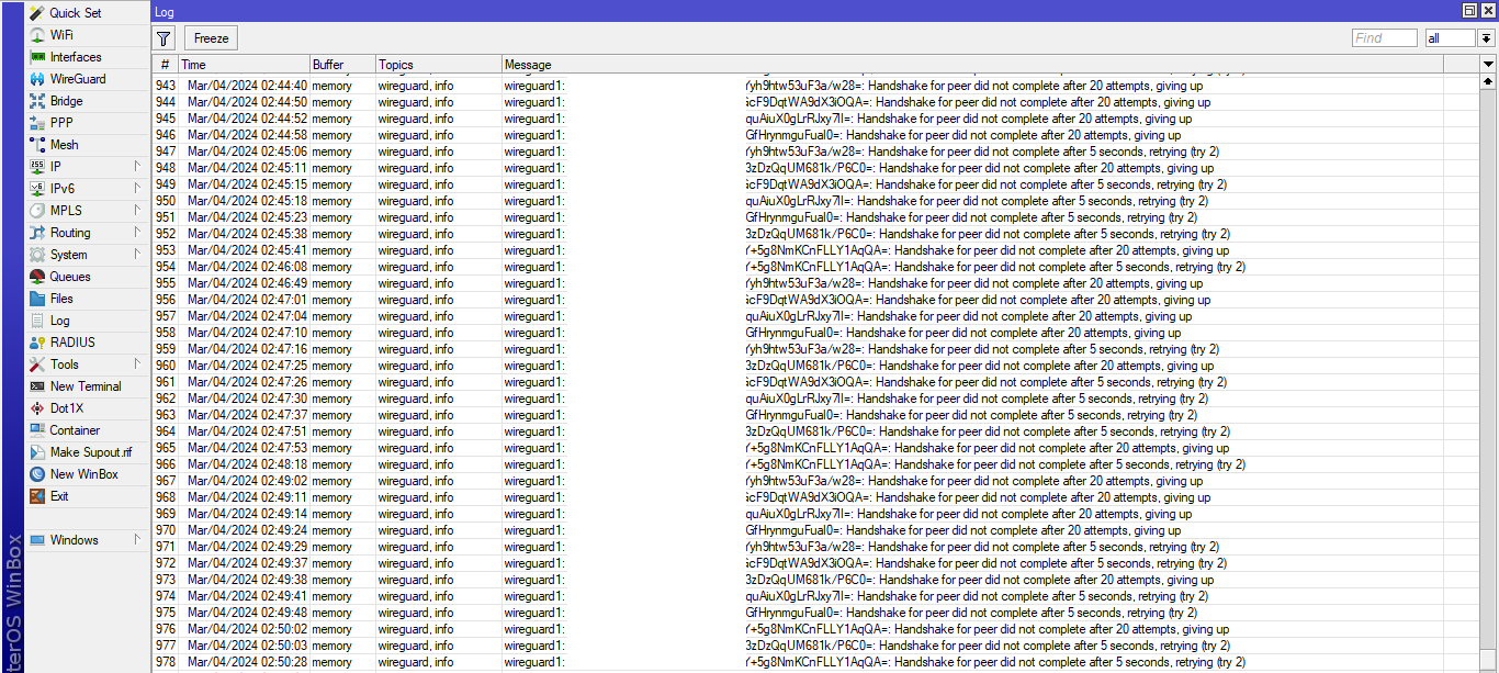

Wireguard log messages
You have really good logging!
What happened??
Please help if there is any problem or issue
I’m experiencing same logging spam since version 7.14

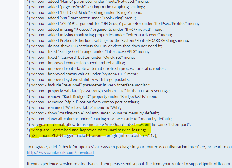

If you download new software the first things you should do is read the thread on the new software as users will report issues there.
Have a read, http://forum.mikrotik.com/t/v7-14-3-stable-is-released/174007/1
Yes I have read
“in 7.14 they optimised and improved wireguard service logging”
my log is always full with iwireguard.
how I can stop this type of messages in logs
