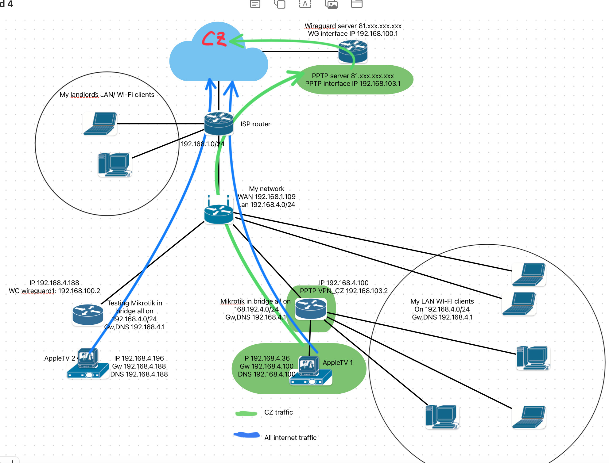

here is the situation:
I have PPTP server and mikrotik as a client. On diagram on the right side
mikrotik is behind Isp router and my router as well.
I have Apple TV connected to it on 192.168.4.36, gw 192.168.4.100, dns 192.168.4.100
on the mikrotik there is script sniffing predefined domains and fills firewall’s address list.
mangle prerouting marks the packets and they are sent to routing table which has its own gw to the pptp VPN. green line.
the rest of the traffic is going to the internet blue line.
this works perfectly.
on the other hand:
I also have (for testing) another mikrotik with another Apple TV on the diagram right side
mikrotik is also behind Isp router and my router as well.
I have Apple TV connected to it on 192.168.4.196, gw 192.168.4.188, dns 192.168.4.188
on the mikrotik there is the same script sniffing predefined domains and fills firewall’s address list.
mangle prerouting marks the packets and they are sent to routing table which has its own gw to the wireguard VPN. (there is no line, because it doesn’t work) :frowning: :frowning: :frowning:
the rest of the traffic is going to the internet, blue line.

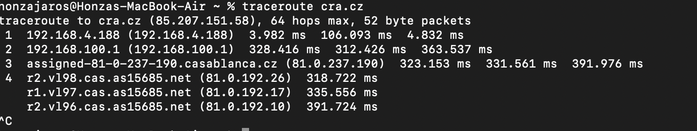

I have handshake and I can ping 192.168.100.1, the other side
BUT
as I mentioned all above work only with PPTP, not the testing with wireguard
goal is to make the wireguard run, and then transfer the settings to the first mikrotik (right) router and then turn the pptp off and have (just in case) the settings stored as a backup (because it works)…
thank you all for help
Here is a map:
here are the exports

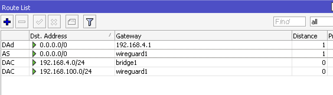

add action=masquerade chain=srcnat out-interface=wireguard1
add disabled=no distance=1 dst-address=0.0.0.0/0 gateway=wireguard1 pref-src=\
    "" routing-table=CZ_VPN scope=30 suppress-hw-offload=no target-scope=10

Your initial explanation is a mess and didnt understand at all.
Please at least draw a network diagram…
updated the original post too, but here is the diagram I made
I am on the end of my knowledge, and would like to find out why it doesn’t work.
thank you for helping
can @anav help pls?

On the RB750Gr3, I dont see any wireguard settings???
I gather the RB941-2nD is a wireguard client connecting to some server…
It looks okay.
But why does this device not have any local subnets???
But why does this router not have any WAN, where is internet connection coming from, MISSING information.
I see no firewall rules either…
Hi, thank you for your reaction.
750 is without wireguard, because I just could not make it work so I backrolled to PPTP only for now and set the 941 as a testing MT. but once it work on the testing, I will transfere the settings here.
on 941 I successfully achieved handshake.
no local subnets, only taken from DHCP as a client of the router, it is in the bridge and on 192.168.4.0/24 subnet, the main router is connected through ether1.

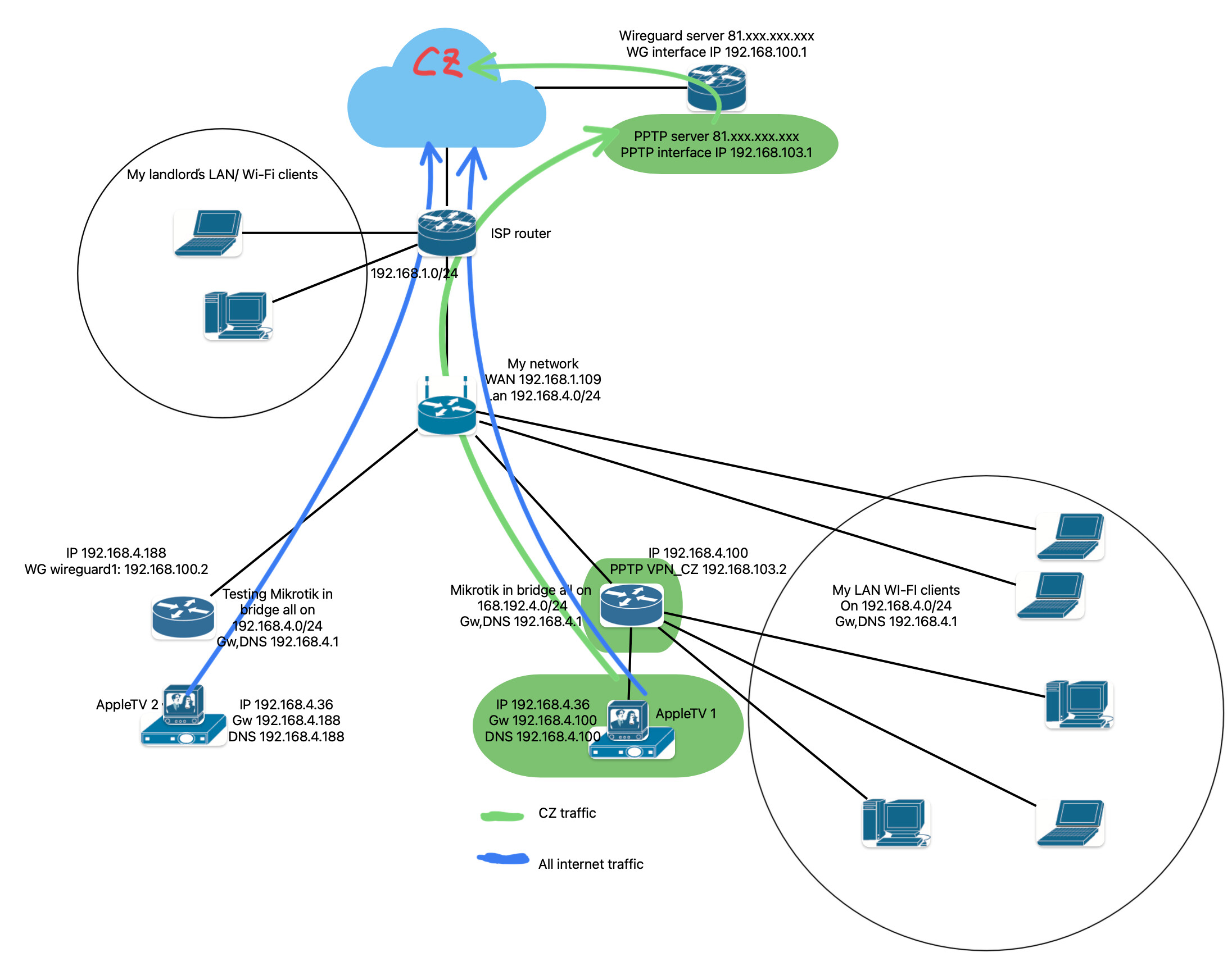

I noticed there is an error on the picture I posted. the appleTV 2 has different IP 192.168.4.196 corrected below:
I hope it bring a bit o sense.
as I try to explained above. the MT2 (192.168.4.188) is exact settings clone of MT1 (192.168.4.100) the difference is MT1 has a functional pptp with internet and lan for appleTV1 and Czech content through PPTP and the MT2 has functional internet for appleTV but goes through the wireguard at this stage, shows the app’s videos, but doesn’t start streaming :frowning:
it looks like, kind of, the server is filter or not passing my packets out
no firewall. it sits behind the router so I guess it doesn’t need any rules except the ones for mangle and srcnat for vpn
I am starting to think, that there was actually all set on my side properly and there might be a problem on the server… firewall and filtering
lets assume my config is alright.
and there is something wrong on the server…

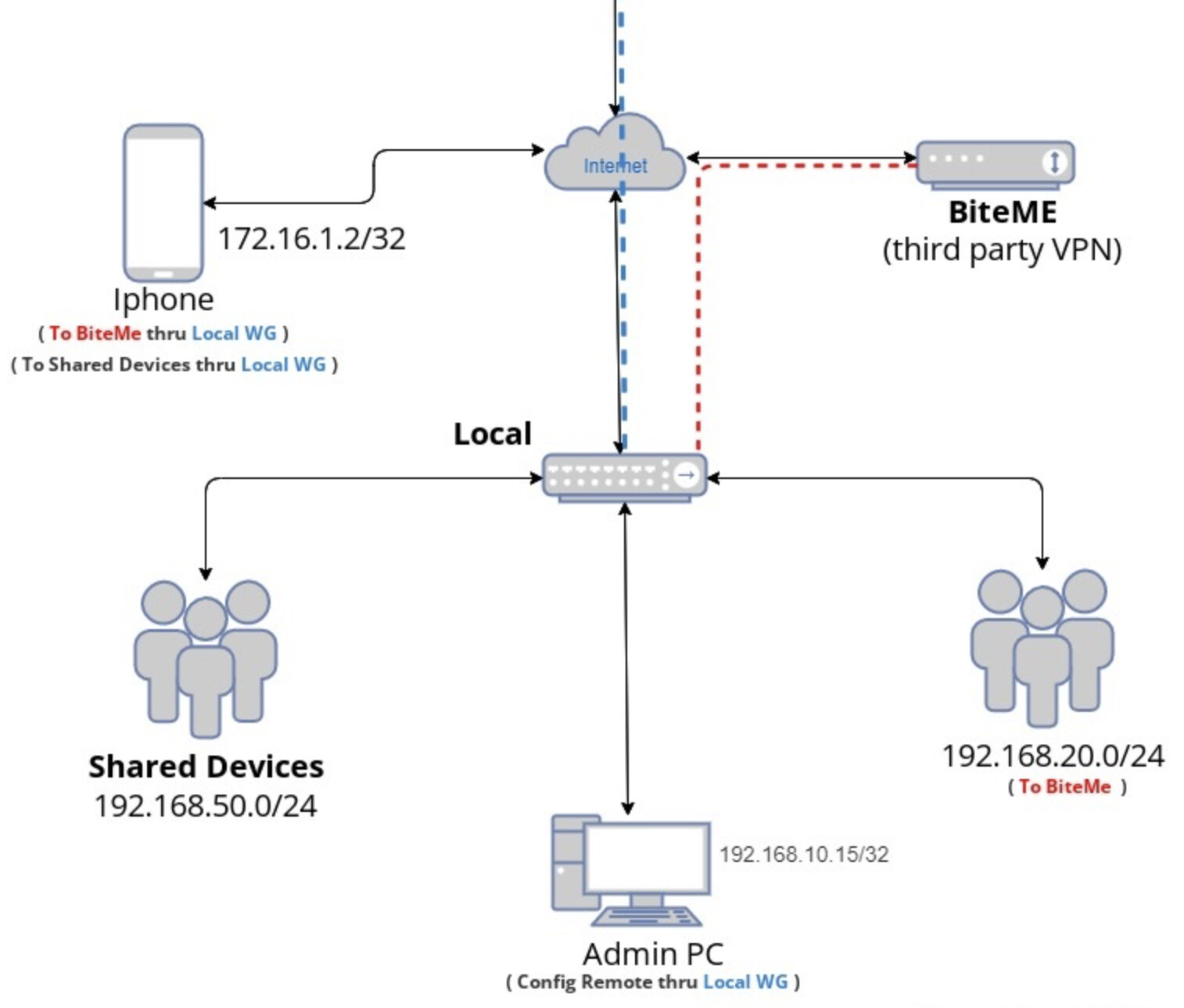

I did a lot of reading of your post recently.
if the picture above is similar to my problem. the people (to biteme) on the right is AppleTV (192.168.4.196), lets assume I have successfully passed all packet suitable to wireguard to the tunnel.
could you point me out, what config, firewall, routes etc should be on the server (on this picture the biteMe)?
I put there obviously input port accept, and nat
 ;;; masq. vpn traffic
      chain=srcnat action=masquerade src-address=192.168.100.0/24 log=no log-prefix="masq"
the nat allowed actually the app to show content, but there must be something more to it…
I will appreciate your help

so I did,
I took my laptop, disconnected appletv from cable. gave laptop same ip, same gw and same dns
here you can see
so the script and filter does its job.
first ping goes to internet from AU. then the filtr script goes through DNS, fills address list and preroute sends the traffic to the VPN.
and it doesn’t stop. traceroute takes it the right way up to the end. so I don’t know why its not streaming :frowning:(
but ping and traceroute is different protocol then streaming…
also, I tried to go to the service through website, absolutely the same, I see the content, no stream
