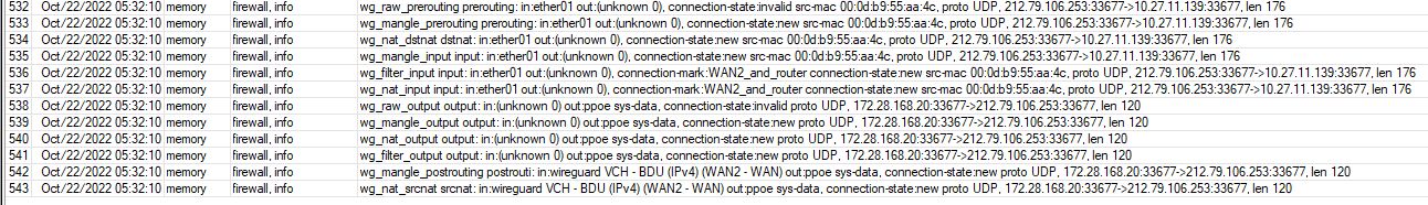

I have a remote client that would like to connect to WAN2 over wireguard so it tries to connect to Y.Y.Y.Y on port 33677 (as in example). It enters fine and the communication goes well throught the whole firewall rules. I assign the connection-mark WAN2_to_router with a mangle rule to identify the connection later.
As soon as the incoming communication is processed on IP Yl.Yl.Yl.Yl, the outgoing (src) communication goes from another interface on IP Xl.Xl.Xl.Xl. Even though it could have, I still assigned the WAN2_to:router connection mark previously but it got stripped so I cannot force it to assing a new routing-mark WAN2.
This is the log from firewall which I hope clears it up a little bit. I simply cannot force the outgoing communication to continue with the same src address as the incoming communication. I also looked at the packet flow but still cannot find a way to force the packets leave on the same interface.

What happens though is that within routing decision the dst address 10.27.11.139 on eth01 (WAN2) is changed to src address 172.28.168.20 on pppoe (WAN1). For some reason it switches the outgoing interface and drops the connection mark anyways so it behaves as if it was a completely new connection. Also it set the connection-state to new, as if it was not replying.
This is what I can see in the Firewall connections, which shows incoming and outgoing communications.

The client is a Windows 10 with the current version of WireGuard.
[Interface]
PrivateKey = …
Address = 10.8.1.100/24
[Peer]
PublicKey = …
AllowedIPs = 10.8.1.0/24, 192.168.10.0/24
Endpoint = …:14232
HEX
Overall cannot see anything that would be stopping wireguard traffic.
(1) I would put in an explicit allow rule just to be sure on the forward chain
FROM
“descarta conexoes vindas da internet que nao tenham base no nat”
connection-nat-state=!dstnat connection-state=new in-interface-list=wan
TO:
add action=accept chain=forward in-interface=wireguard1 out-interface-list=LAN
WINDOWS CLIENT
(2) Client Address incorrect
FROM:
10.8.1.100/24
TO:
10.8.1.100/32
