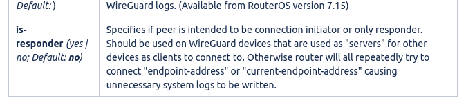

I noticed in the 7.17beta2 notes:
*) wireguard - do not initiate handshake when peer is configured as responder;
Which is great, but I am confused about the wording in the documentation: (https://help.mikrotik.com/docs/display/ROS/WireGuard#WireGuard-Peers)
There seems to be an as-yet-undocumented change in 7.17 that renames ‘is-responder’ to ‘responder’, so I’ll just say responder.
I don’t understand which side’s peer is supposed to be set to responder. It seems like the roaming peer would be the “initiator”, since it is the one that always knows the servers endpoint-address, right? So the server’s peer entry on the roaming device should have responder=yes? Then how does that tell the server not to log failures to contact the roaming device at it’s last known endpoint-address? Maybe the server is the one that needs responder=yes on the roaming peer? It seems to me that the meaning of the terms are lost if that is the case.
I’m guessing it is the second one and the term responder actually refers not to the peer, but the device the configuration is on, even though it is in the peer configuration.
It would be nice to have it clarified, at least as an example in the documentation. If it’s being renamed for 7.17 anyway, maybe it could be called respond-only or similar.

It’s still unclear to me, on which side and in which peer-definition I set responder=yes?
Let’s assume I have a central router with a static-IP (which should act as the server “responder”). And we have a few “road warriors”, who have dynamic-IPs and must initiate the connection.
Do I set responder=yes in the “server” (the router with the static IP) and on this device in the peer-definition of the dynamic-IP-devices “road warriors”?
Or do I set this in the road-warrior-device and there in the peer-definition of the “server”?
You can read the documentation both ways. And even in a lab with both sides set to “responder=yes”, the tunnel is established (v7.16.1).

As per the documentation:
responder (yes | no; Default: no) → Specifies if peer is intended to be connection initiator or only responder. Should be used on WireGuard devices that are used as “servers” for other devices as clients to connect to. Otherwise router will all repeatedly try to connect “endpoint-address” or “current-endpoint-address”.
To me that indicates the term should only be set to YES, on the allowed IP settings on client peer devices when describing the peer Server Router.
It should never be used on the peer Server Router to describe the peer client devices.

Once I set responder=no to one of my peers, (It is an iPhone , connect to my AX3 sometime), the log of AX3 will say:
 2024-11-05 16:28:36 wireguard,info wg3: [ZhY] xxxxxxxxxxxxxxxxxxxw=: Handshake for peer did not complete after 20 attempts, giving up
and then set reponder=yes to it , the message dispeared .
According to offical documents , I think this roaming iPhone always “be connection initiator”, so it should be mark as a responder .
