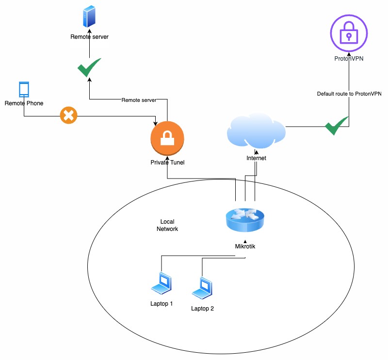

Hi, and thank you for your detailed response.
  1. Schema :
    https://ibb.co/yFQjmfr

  1. @sindy I must admit that I’m not sure I fully understood all the technical aspects of the proposed solution.
Let me clarify my current Wireguard traffic configuration:
  1. I have set up a rule in the “output” chain that forces outgoing traffic from my private Wireguard tunnel to go through my Internet box rather than through ProtonVPN.
  2. I can confirm the effectiveness of this rule through two observations:
  • Without the rule:
  • Ping to my remote server ~100 ms
  • The IP address visible as “peer” on my remote server is ProtonVPN’s
  • With the rule active:
  • Ping returns to ~8ms
  • The IP address visible as “peer” is indeed my Internet box’s IP
Is this the issue you were referring to in your explanation? Or did I misinterpret your response?

Please post drawings as direct attachments here - few people here would visit external sites fueled by advertising.
This rule is indeed necessary, but it is not sufficient. I must start the explanation from the connection tracking module of the firewall.
The connection tracking module serves multiple roles - most importantly, it provides the connection-state meta-field to packets to simplify the structure of the firewall rules and it takes care about NAT. Its functionality depends on an ability to identify an already existing connection to which a packet belongs. For generic UDP connections, the only fields that can be used for such identification are the addresses and ports.
If a packet does not match to any connection that is already in the list, it creates a new one. And all the NAT decisions are made while processing such an initial packet and their results are stored in the context data of that connection. All subsequent packets of the same connection inherit an appropriate NAT handling, same or mirrored, depending on their direction.
Now let’s use an example - the mobile client sends the first Wireguard handshake packet; there may be some source nat in the mobile network so we’ll receive the packet from address 1.2.3.4 port 12345 to our WAN address 192.168.1.x port 56789. Since there is no dst-nat rule on the Mikrotik itself, and since 192.168.1.x is an own address of the Mikrotik, a tracked connection will be created with both src-address and reply-dst-address set to 1.2.3.4:12345 and both dst-address and reply-src-address set to 192.168.1.x:56789. If the process listening at 192.168.1.x:56789 was any other one than Wireguard, it would send its response from 192.168.1.x:56789 so the response would be identified as part of the existing connection and be sent to 1.2.3.4:12345 without any change. However, the Wireguard process will choose the source address for the response using routing table main, so it will send a packet from 10.2.0.2:56789 to 1.2.3.4:12345. So from the point of view of connection tracking, this will be an initial packet of a new connection, so it will indeed create a new one. Normally, the masquerade rule would set the reply-src-address to 192.168.1.x:56789 and send the packet to 1.2.3.4:12345, but such a combination of dst-address and reply-dst-address would collide with the combination of src-address and dst-address of the connection created by the initial packet that came from the mobile client, so the connection tracking will use some other port than 56789 (let’s say 1024) to prevent this. And such a packet will not match the original connection at the mobile network end, so the mobile network will not deliver it to the client.
To prevent this from happening, you need to play along, by using a dst-nat rule that will redirect the initial packet from the client from 192.168.1.x:56789 to 10.2.0.2:56789, so that the response from 10.2.0.2:56789 could be identified as belonging to the same connection and get “un-dst-nated” rather than “src-nated” (which is of course the same change from 10.2.0.2 to 192.168.1.x but from the logical point of view it has a different reason).
