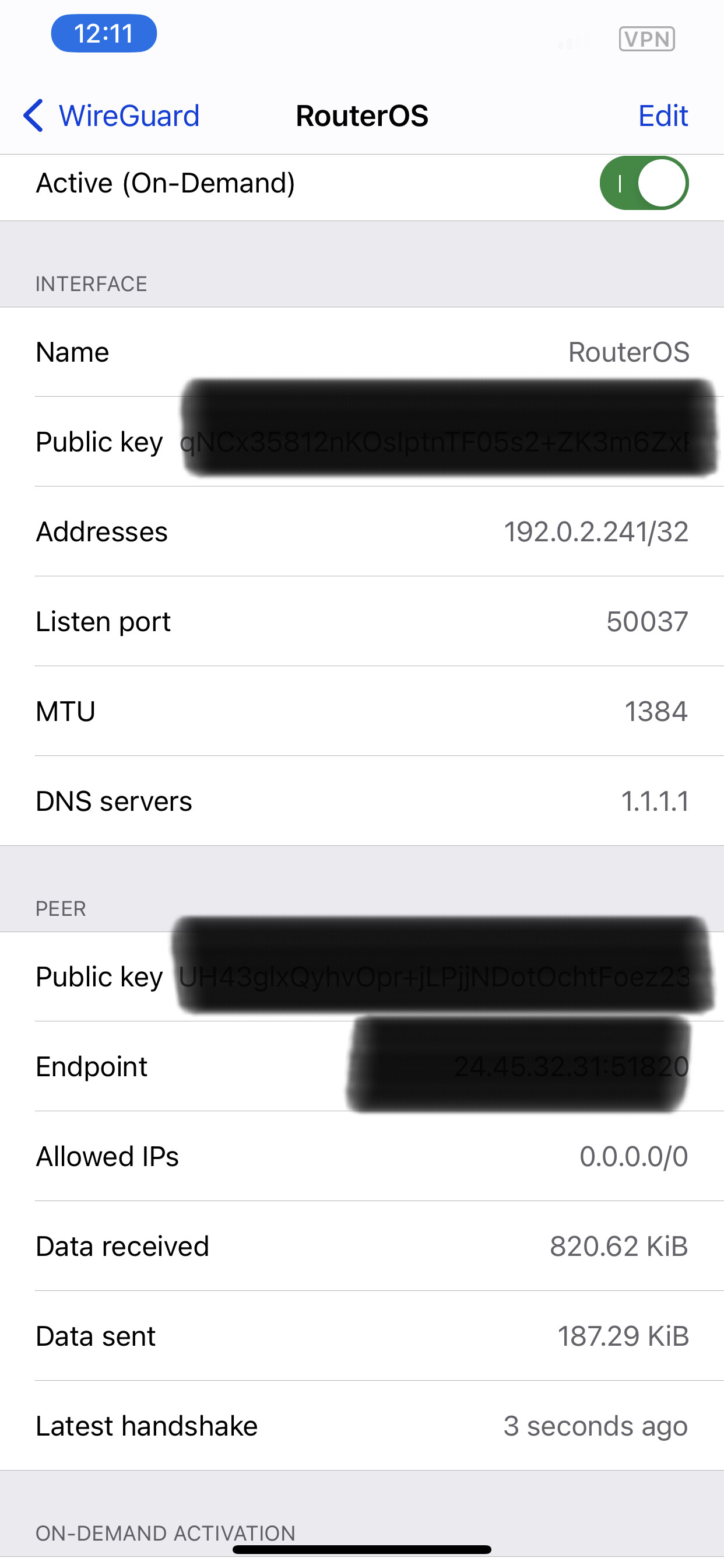

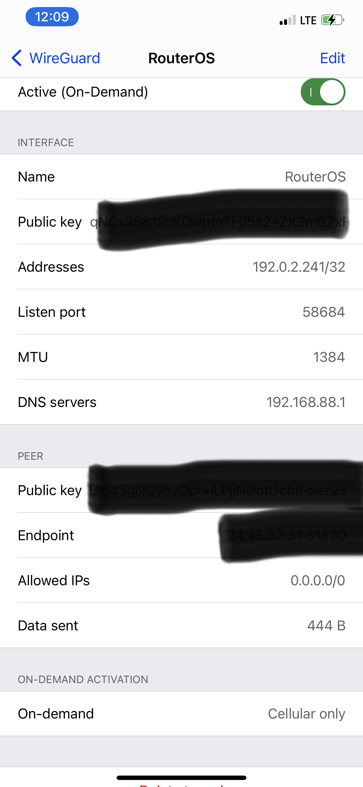

I am not sure if the attachments help illustrate the problem better..
Specifically Data Sent and Data Received entries.. (no dns no data moving..)
From Wireguard I cannot use my dns cache hosted on the router endpoint, using any of the directly connected/configured interfaces..
The dns cache works, there are cache hits within the process.
Lan clients do not have this problem, or any other problem.. just Wireguard clients using the router dns cache.. that seems to be the exclusive problem.
Thank you again..
(1) Keep the MTUs the same on sender receiver, so give it a go with both at default 1420, and then try the funky 1384.
(2) Why did the listening port CHANGE on the two examples ( thought you were showing me using 1.1.1.1 and using 192.168.88.1 and both not working )??
(neither matched config listening port)
Possibly the iOS client works differently..
The port shown is the local ephemeral port.
When you make a change to the client it reconnects and chooses a new local ephemeral port for its outbound connection.
