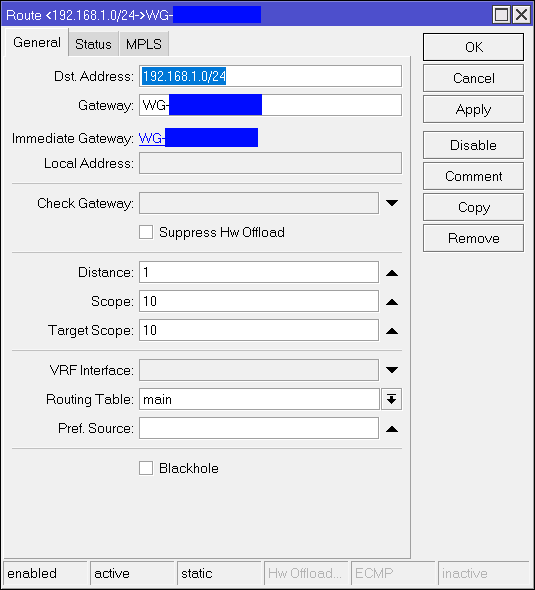

Assuming Site B is acting as a client to Site A with Wireguard connected over IPv6, it seems like it should work.
Site B has keep-alive configured?
The static route you talk of is for 192.168.1.0/24 via Wireguard1?
You have appropriate black hole routes or filtering for 192.168.1.0/24 otherwise?
Yes Site B acting as client.
I also thought this should work, but somehow either a configuration is missing or I have found a bug.
Yes 25sec
Correct.
No.
I have only created firewall rules to allow access from 192.168.178.0/24 to 192.168.1.0/24.
From 192.168.1.0/24 to 192.168.178.0/24 I have only created one firewall rule so that established and related connections are allowed.
