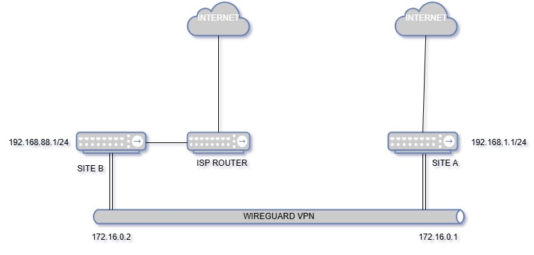

I am trying to set up a WireGuard site-to-site VPN; however, I am having trouble correctly configuring static routes. I have done this before with L2TP/IPsec without any issues, but for some reason, a similar setup with WireGuard isn't working.
Here’s the setup:
Site A: Has a static public IP address.
Site B: Mikrotik is behind double NAT. It has a DHCP client configured on Ether1, and my goal is to push all traffic through the WireGuard tunnel so that all devices connected to Mikrotik at Site B use the public IP address of Site A.
The tunnel is up. From Site A, I can ping any device on the LAN at Site B, and vice versa.
The problem comes up when I try to configure a route with:
dst 0.0.0.0/0 gateway 172.16.0.1 distance=1.
As soon as I activate this route, the tunnel goes down, and I am no longer able to ping the other end of the tunnel.
I am attaching a network diagram.

You need to set on site B route to Site A public up via local gateway.
That's what I have done
Dst 0.0.0.0/0 gateway 172.16.0.1 which is the other end of the VPN tunnel. distance is 1.
I know it's reachable because I can ping everything on the other end.
However, once this route is activated, the tunnel goes down.
It dies as WAN traffic from router A to router B (that includes the tunnel) is send to the tunnel so it dies as WAN-A traffic does not reach WAN-B (and vice versa). When tunel dies then VPN is established/routed with an "old pointing to the <> " 0.0.0.0/0 and then it loops itself again to the tunnel … and so on.
Not the tunnel endpoint for route destination but WAN address
Thanks for your response! What changes are required to get this fixed?
So shall I replace in static routes 172.16.0.1 with the public IP of site A?
Post both configs
/export file=anynameyouwish (minus router serial number, any public WANIP information, keys etc. )
Here is the full config. There is the config for other tunnels as well at site A so please ignore it.
