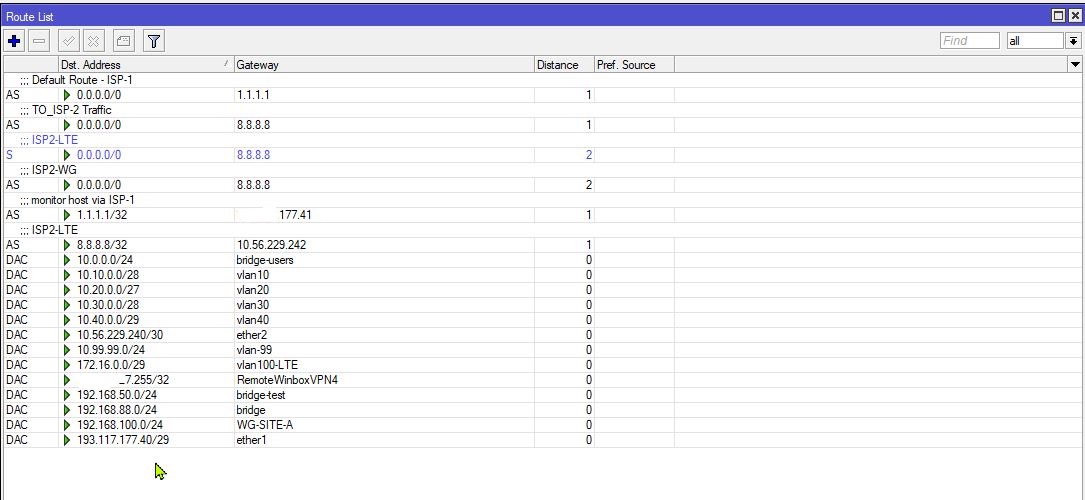

Files requested attached, to avoid any confusion I only require wg to go via WAN2 at all times, not concerned if it goes down
MK-5009-SITE A.rsc (26.3 KB)
