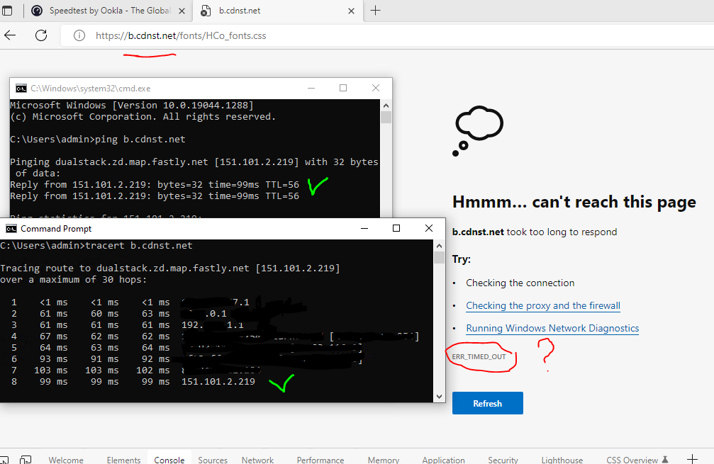

Hey guys, I have a question regarding properly setting up a wireguard VPN tunnel.
So I have a HA3 connected to internet and I have a wireguard VPN client running on it. VPN is up and running normally. The issue is that I have a PC on the br-lan which is mangled to go through VPN, at least the idea is to have all traffic on that PC routed through VPN but when I run speedtest.net the HTML file is loaded but all the JS files timeout (.
So the question is how can I check why not all content is downloadable through VPN?
The destination IP is pingable from the PC no problem also tracert shows that the requests are going actually through VPN connection like [mik router] > [VPN] > [remote router] > [internet] but when I paste the URL into my browser the content is not loaded
THE CONFIG DOESN NOT MATTER AS LONG AS YOU CAN PING THE OTHER SIDE AND AT LEAST OPEN YOUTUBE OR GOOGLE!!!
on tracert cmd the we have the whole path as
  1. is local LAN
  2. is VPN tunnel
  3. is remote LAN
  4. is remote ISP
    Also configuring the same Wireguard connection on the PC directly with the exact same settings as used in mikrotik’s wireguard makes all the issues to be gone, which makes me think that something wrong is on my router
SOLUTION: [b]JUST SET THE SERVER'S MTU TO 1500[/b] should fix the issue
Note Steps 2 and 1.

Could be an MTU problem. On the WG-Client connection on the local router and on the client router set both MTU to 1500 (default is 1420 - which works fine in 95% of cases) and see if that fixes the web issues…
Set MTU to 1420
Try use mangle rules to mark routes exacly to wireguard.
Also turn off fasttrack if enabled, in my case fasttrack was a source of all problems with wireguard.

Okay so keep the mtu to defaults 1420, get rid of the mangles noted above and put fastrack back in.
We are going to try MSS Clamp!
Go to client mikrotik, thi is not done on server so on the WG-Client interface…
Go to mangle rules and addd new mangle rule
add chain=forward protocol=tcp out-interface=WG-Client
Then go to ADVANCED TAB at top,
Go to TCP Flags
select from the pull down → syn
Go to ACTION TAB at top…
select ----> CHANGE MSS
GO TO new TCP MSS:
select → clamp to pmtu
(if that doesnt work try setting it to 40 less than MTU setting in this case 1420-40=1380)
What is WG client interface connecting to… whats at the other end another MT router if so please post its config…
If not what is it??? and what settings did they give you to use??
YEP set server to 1500 resolved the issue.
THANKS!!!
