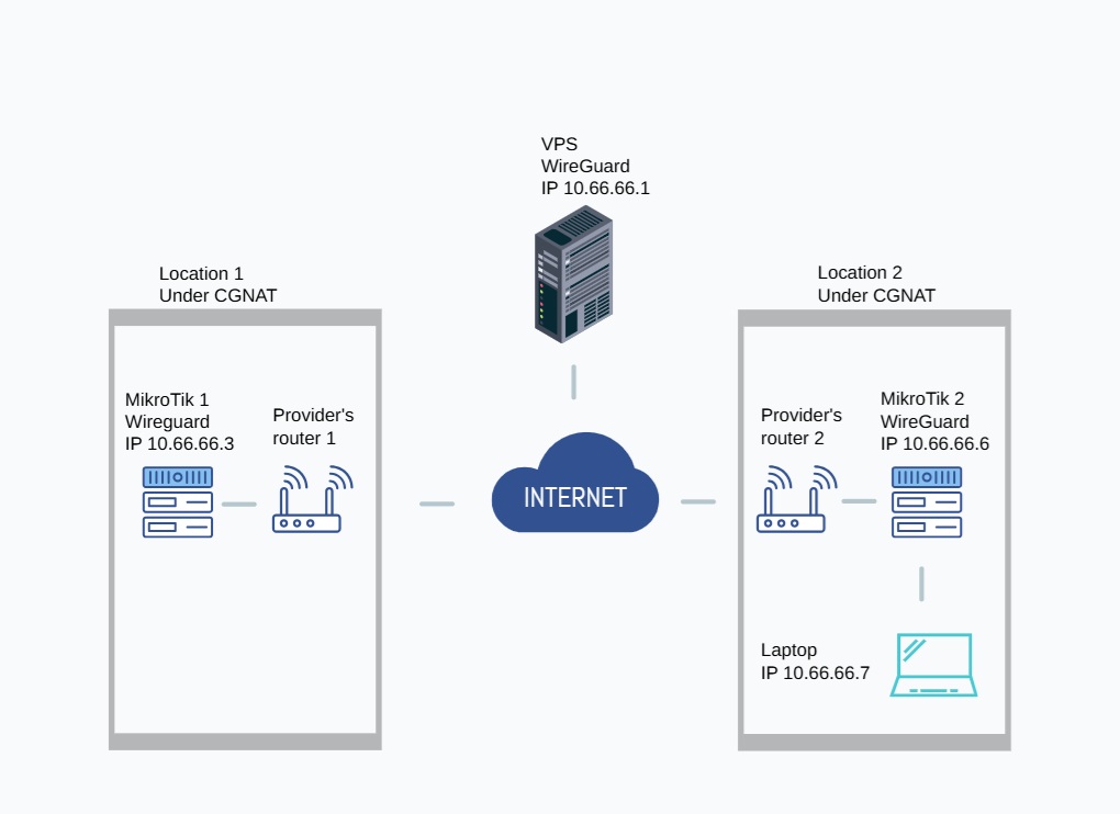

I have 2 locations: location 1 and location 2
Both locations have:
  • provider’s router located behind CGNAT
  • my MikroTik router RB5009UG+S+IN with RouterOS 7.19.3 and WireGuard
Because of CGNAT, incoming connections to MikroTik from internet are impossible,
so I have VPS with static public IP, WireGuard installed, and both MikroTiks are connecting to VPS.
Also I have laptop in location 2
which is connected by ethernet cable to MikroTik 2
I can’t install any software on this laptop.
Laptop should go to internet via MikroTik 1 - all third-party observers should see as it is geographically located in location 1
Internal IPs are:
VPS 10.66.66.1
MikroTik 1 10.66.66.3
MikroTik 2 10.66.66.6
Laptop 10.66.66.7
What should wg0.conf contain on VPS, so all the traffic from laptop should be redirected to MikroTik 1?
Please advise

Unfortunately, none of my ISPs support IPv6, so I can’t rid off VPS here
