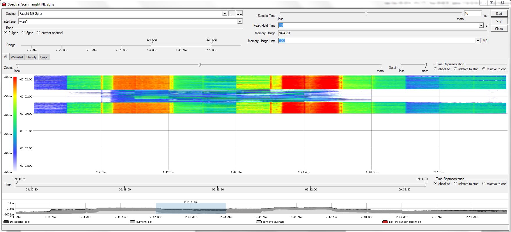

This spectral scan shows what I am talking about. If you look you can see where I turned off the APs on channel 1 and 11 off and then turned them back on. You can see how far outside the range they are going. And how much of a change there is on channel 6.
