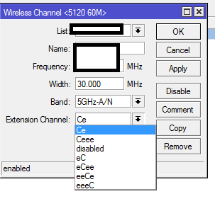

Wireless-fp "Ce, Ceee, eC, eCee, eeCe, and eeeC"
Whenever I select one of the odd ones aside from eC or Ce, it says its not supported. What are they, wider channels? Exentions for use only with 802.11ac cards??? Anyone know?

C is 20MHz contol channel. In 11n you have Ce and eC with 40MHz. In .ac channels can be wider.

As far as I know there is no 802.11ac product for RouterBoards. The “eeeC”, etc. channels are simply support in RouterOS for future 802.11ac products.
In 802.11n mode:
eC = 20/40MHz-ht-below
Ce = 20/40MHz-ht-above
You can see why they needed to rename the values otherwise they’d look a bit like this:
20/40/80MHz-ht-some-above-and-some-below!!
That makes sense. The AP rolls back to 20MHz for compatibility, right?
Yes. To the “C”-Channel.
What about (Ce | Ceee | eC | eCee | eeCe | eeeC ) ???
eC mean Extend Channel below : 20Mhz?
eCee mean Extend Extend Channel below : 40Mhz?
eeCe mean Extend Channel below : 80Mhz?
eeeC mean Extend Channel below : 160Mhz?
or how?
and why Ce and Ceee but there is no Cee ?
C- is center of frequency
e - is extension channel
example : frequency is 5100 and in eCee will be see (5080-e,5100-C,5120-e,5140-e)

Each letter denotes a 20MHz channel section.
C: is where the Channel’s main frequency is set
e: is where the rest of the spectrum “sub-channel” is distributed
There is no “Cee” because that would equal 3x20MHz combined channels to make a 60Mhz channel, Mikrotik currently only has 20/40/80 channel width available for AC.

Note - Below , the bolded 20 is the frequency the radio is set to.
Normal 20 MHz wide is C
C = 20 MHz wide
( Total is 20 MHz wide — 20 )
Ce ;
C = the center 20-MHz wide frequency the radio is set to
e = an additional 20-MHz wide frequency that starts above where C stops.
( Total is 40 MHz wide — 20 + 20 )
Ceee ;
e = an additional 20-MHz wide frequency that starts above where e above stops
( Total is 80 MHz wide – 20 + 20 + 20 + 20 )
eC ;
e = an additional 20-MHz wide frequency that starts lower than where C begins.
( Total is 40 MHz wide – 20 + 20 )
eeeC ;
e = an additional 20-MHz wide frequency that starts lower than where e below begins.
eCee ;
Info
If we have a 20 MHz wide channel setting at a frequency of 5500 ,
The frequency use begins at ( 5500 - 10 ) = 5490
The frequency use ends at ( 5500 + 10 ) = 5510
If we have a Ce (40 MHz wide) channel setting at a frequency of 5500 ,
The C frequency use begins at ( 5500 - 10 ) = 5490
The C frequency use ends at ( 5500 + 10 ) = 5510
The e frequency use begins at ( 5500 + 10 ) = 5510
The e frequency use ends at ( 5500 + 10 + 20) = 5530
North Idaho Tom Jones
Of special note:
If you have a eCee configured AP
A eC client should get an eC connection
A Ce client should get a Ce connection
A Ceee client should get a Cee connection
A eeeC client should get a eC connection
A normal C ( 20-MHz ) client should get a ( 20-MHz ) C connection
If I am correct - A XXXX client will auto connect and get the widest possible connection.
A XXXX client connected to a normal 20-MHz C AP should get a 20 MHz wide connection
A XXXX client connected to a Ce or eC AP should get a 40 MHz wide connection
A XXXX client connected to a Ceee or eCee or eeCe or eeeC ap should get a 80 MHz wide connection.
Note - the above connection channel widths are based on good/clean/clear frequencies.
If you have a XXXX client or a Ceee clinet -and- a Ceee AP , but the e frequencies busy and congested , you may only get and maintain 20 MHz wide connection.
If the center band C frequency is busy and congested , then no clients might be able to connected ( C busy and all e frequencies quiet ).
So , when you configure a Ce, Ceee, eC or eeeC AP , the C frequency range on your AP is the most important clean frequency to get client connection.
