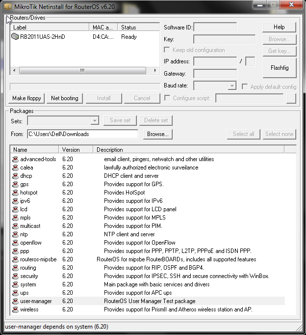

I followed the instructions. Frankly, I am not certain whether netinstall did not work properly or whether using netinstall did nothing. I say this because I follow the manual and I am told a Reboot button will replace the Install button in the GUI, this did not occur. So, I did a reboot by pulling the power. See images. The “installing” image occurred before the “ready.” The timestamp used for the filename of the images is accurate.
After the reboot, the wireless interface did not appear.
So what failed, the router or netinstall or both?
Try netinstall again with all-packages.
Same result. See images. I am guessing that the netinstall failed, for it does not take long.
