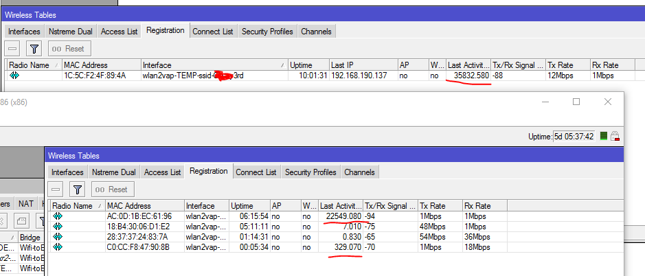

Im noticing on a few of my APs , clients with Last Activity of 1000s of seconds (see attached image please, when i cross ref. the clients with high last activity times, with their dhcp leases, they are always Phones, iPhones mainly and sometimes android phones) - also i have noticed the devices must be sleeping, because when they are active their signal strength with jump up 20 or so db. This is something i have not seen at prior installs (all the MTs are running ROS 6.36 or newer , most have XR2 2.4ghz radio cards in RB 433)

it doesnt seem to cause any issues, that i know of, but it does cause issues with monitoring or data gathering (ie wireless ints show 30+ clients , when only 5 are real).
