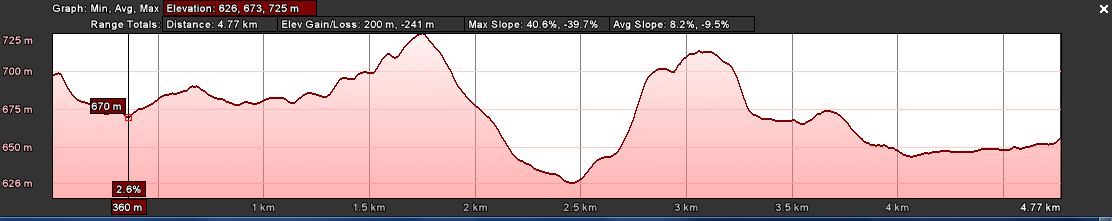

I have attached an elevation profile from Google Earth. And the high points between my two locations are hillside/rock.
If your endpoints are at vy begining and end of your profile (e.g. the small 700m ASL hump at left side and the end of the picture at the righ pix side) - may be - with 20dBi or more yagis on 900MHz (XR9s) and 5MHz/10MHz channels … and the highest obstruction is rock or sparse vegetation … again, may be you can take advantage of something called knife effect. A 20dBi loop yagi can have 2.2m long boom.
On both sides the antennas will be tilted upwards a few degree. The signals hiting the obstacle at 1.75Km should bend down. But this is just the theory. I don´t know how to calculate the attenuation when this effect came up because the signals bent downwards - and - spread horizontally (I mean, if it was a 10º beamwidht after the obstruction it could means 30 … 50º beamwidht, spreading the power).
And you have 2 obstructions …

Oops, i apolgize i didnt clarify that. You are correct my two locations are at the very beginning and very end of that profile. This is shooting up a mountain valley so the 2 obstructions are hillside/mountainside (the valley has a slight “S” shape to it). I am going to research some Yagi antennas and i was already planning to use XR9’s. Would a grid antenna make sense for this type of link over a yagi?
