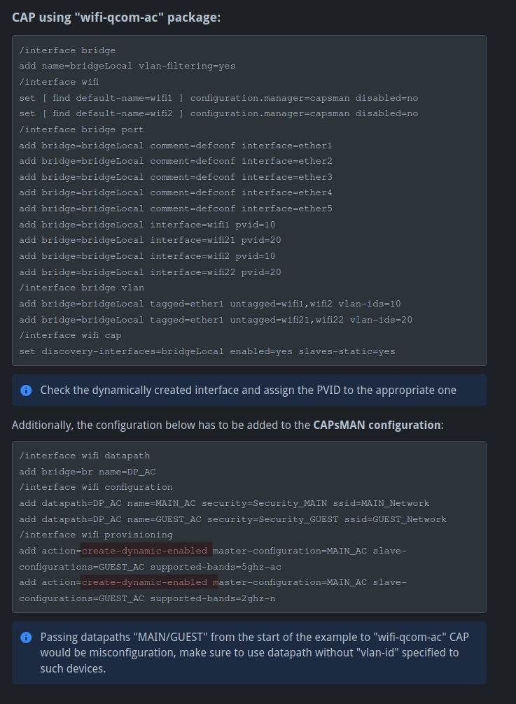

On Controller: WiFi → Provisioning → open your config, as action select “create enabled”
Isn’t this part of the docs wrong for wifi-qcom-ac? You cant have manual bridge ports when create-dynamic-enabled is used in provisioning rules.
I don’t know it it’s a bug in documentation … but I have to set action=create-enabled to be able to manually set VLAN parameters on CAP device (which runswifi-qcom-ac). Exactly as @m4rk3J instructed in the post above yours.
I had create-dynamic-enabled but still was able to put them into the VLAN. I haven’t touched interfaces, but bridge only. And they were recreated after reprovisioning.
I will try to set create-enabled and slaves-static=yes and see if it works.
Sorry to highjack this topic. But inspired by this topic I wanted to assign a vlan to slave-wifi on my cap ac (controlled by capsman). But for the life of me I am not able to find out how I can stop routeros to add the interface (wifi4) as a dynamic bridge port. Because of the dynamic ports I can’t assign the pvid to the port. Ideas?
I think you have to not to set the bridge in datapath, then it will not dynamically be added to the bridge port and you can set it manually.
Thanks for the hint! While I already unset the “datapath” attribute on the static slave interface, I also had to unset “datapath” on the master interface.
