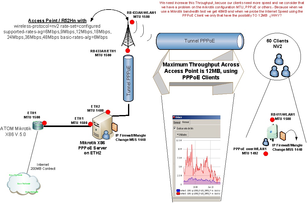

Let me introduce to you understand my situation.- We are installed a Mikrotik network using PPPoE Server/Radius and my small scenery is:
CLIENTS ----> AP/TOWER ------> PPPOE SERVER ------> INTERNET
My situation is: After to install 10 or 25 or more clients over the AP we make a Mikrotik Bandwidth test using Btest.exe over my PC and from each CPE/Client Antenna I execute the test and I get 48MB across the AP.- But when I login on each clients to our PPPoE Server and I allow to all client that can download to 3MB and 300kb upload, the maximum traffic over the AP is 12MB or 12.8MB.
Why is the question? I read it on Internet the follow options:
a.- change the MTU.- But where in all point I mean on ETH1 MTU, WLAN1 MTU, PPPoE Server
MTU, this is the point that the user not specify how.
b.-change the MSS.- I testing but not work.
I attach some diagram please see and send me back your comments please.

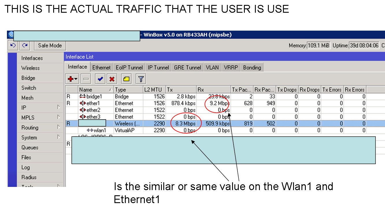

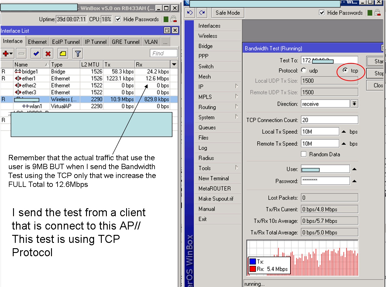

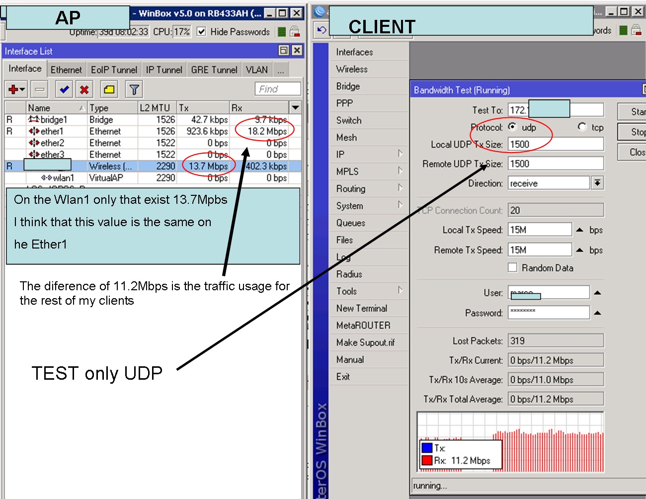

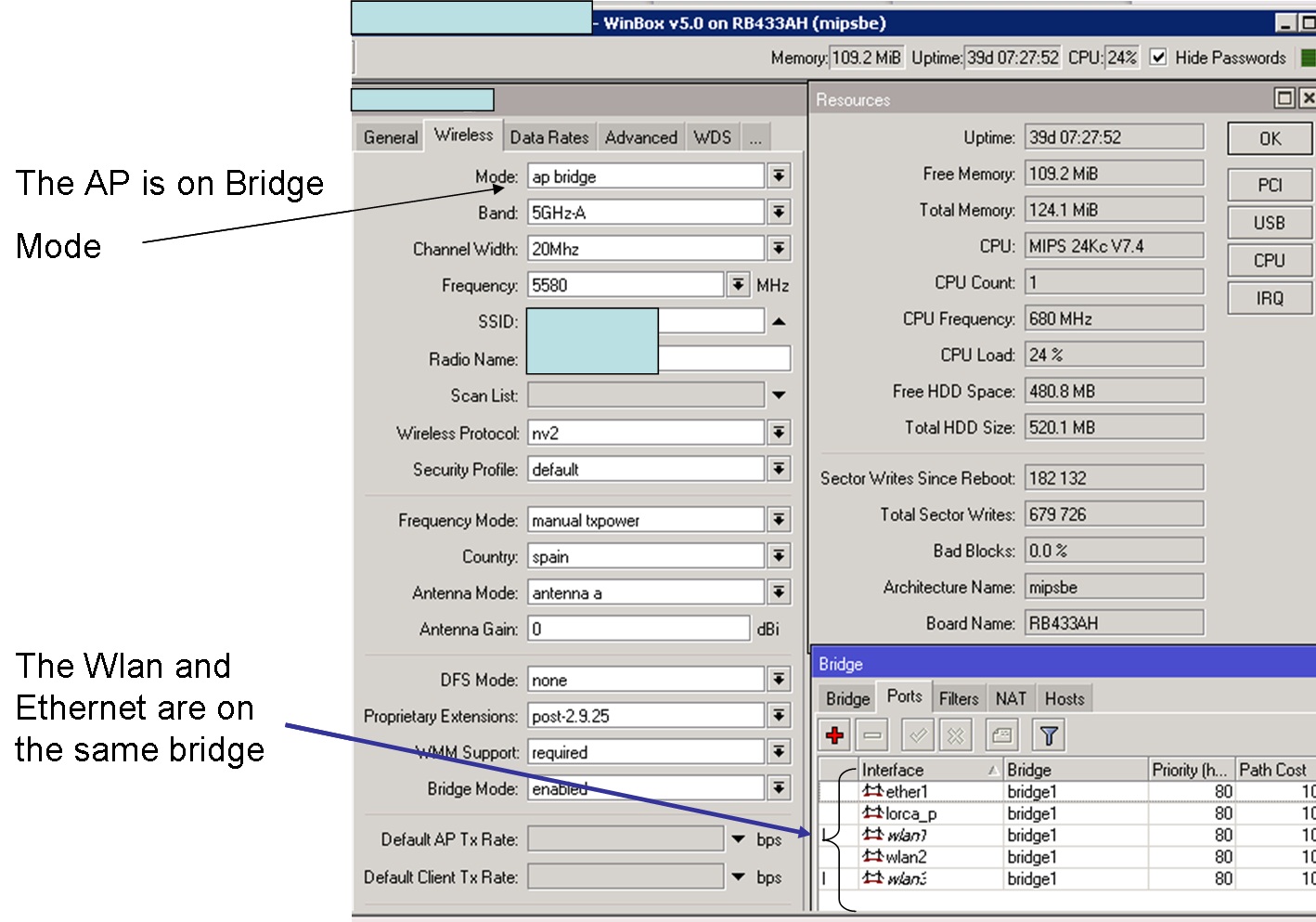

I attach other pic, because I make a test using TCP and UDP from a Client that is connect on this AP and if you observe I have different value on the Throughput.
Actually this AP is in production and it have a traffic of 9MB, after that I make the test I have the follow comments or question.
1.- When I make the test using UDP I can see on the Ethernet-1 of the AP the traffic going
up to 18Mbps but on the Wlan-1 only I had 13.7MB ¿why this difference?
2.- When I make the test using TCP I can see on the Ethernet-1 of the AP the traffic going up
to 12.6Mbps I think that maybe this value will be going up. ¿Why not?
3.- How I can have more TCP or UDP throughput on the AP, I need replace my Routerboard or
my Radio Card?
Please see this pic and send me back your comments

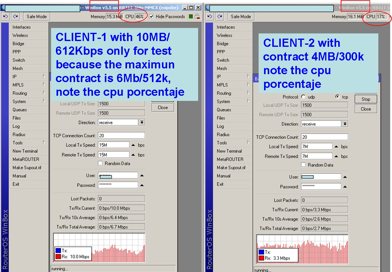

Sorry, for some reason can’t seem to open your attachments, but i think i understand better now. TCP is a better reflection of real life throughput and sounds to me like your actual max speed are around 13 M/s. First of you have to say which model of Router board u are using and also maybe NStream, 802, 11 B, G? A good indication to see if router board is the problem is to see what percentage of CPU you are using at 12 M/s. Instructor once told me above 30% is to much. Try to keep to that rule, never failed me before, though some of my routers do sometimes go up to 50%, but only for a short time. Also in the profile of your PPPoE client set the option, “Change TCP MSS”. to yes. This will create a dynamic rule in firewall that will fix any MTU problems.
Hi
Egate
1.-Mikrotik RouterBoard = RB433AH
2.-We use NV2 Protocol
3.-Data Rates/Configured to Supported Rates A/G=6Mbps-48Mbps and Basic Rates A/G=6Mbps
4.-CPU Porcentage using 12M/s=25%
5.-Change TCP MSS to yes= I had configure before
I read it the article on Internet where some user spoke about this situation but he say that the problem is on the MTU, but I dont know if I need to change the MTU value in all equipment or what..
Please send me back your comments,

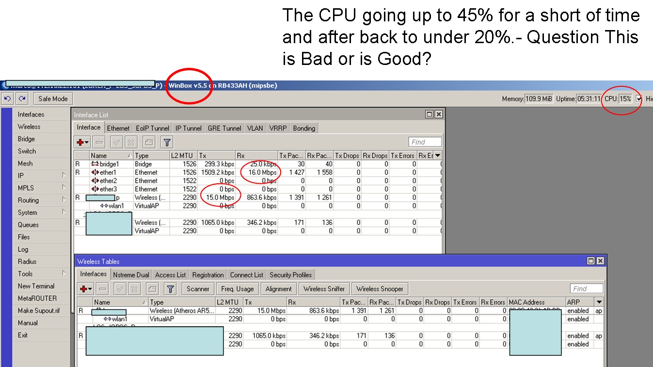

Hi
After to notify my problem to Mikrotik they send me back the follow comments:
1.- Upgrade the AP and Client to 5.5v
2.- Change the PPPoE Server Encryption to NO
3.- Check the CPU usage when I testing the speed
1/:-Done
2/:-Done
3/:-Remember that my Board is a RB433AH and when I testing the speed the CPU going to 45%
only that the time that spend the speed-test, after this time the CPU come back to under
20%.
After to make this changes I can see now on my AP that the traffic going up to 16MB and some time to 20MB.
I remember you that my network is:
Client → AP → PPPoE Server → Radius → under OSPF
For this reason i think that maybe I need more tuning our network only that to get more performance and Throughput, because I dont know if my MTU is right or if I need to make a change under my PPPoE Server/Simple queue because right now we use one for each client and I have more than 1500 clients
For this reason my next question is:
What is the MTU value that I need to use on my networks and if this change I need to do on the wlan client, AP ethernet and Wlan and on the PPPoE Server or where is the only side where I need to change this MTU value and what is the number that I need to use?
Did you think that If necessary to change the simple queue and use other?
thank you

I have setup the MTU in all equipments:
Client
Antenna
Wlan1=1500 PPPoE Client=1480
AP
Wlan1=1500 Ethernet1=1500 Bridge1 (ether1+wlan1)=1500
PPPoE Server
Ethernet2=1500 PPPoE Services MTU=1480
On the PPPoE Server IP/firewall/Mangle I have created the rule to CHANGE MSS TO 1440
Again My question is:
Do you think that I need to change the MTU to 1480 in all equipment or only that into the PPPoE Services MTU?
I apologize because I dont tell you that we have installed PPPoE Server by Main Towers and our PPPoE Server are:
1-50 clients We use RB493
50 - 180 Clients we use RB1100
180+ Clients we use Dual Core PC
What is your opinion about the MTU - please see my graphics picture using safary or mozilla
with>my PPPoE Server MTU with 1480
