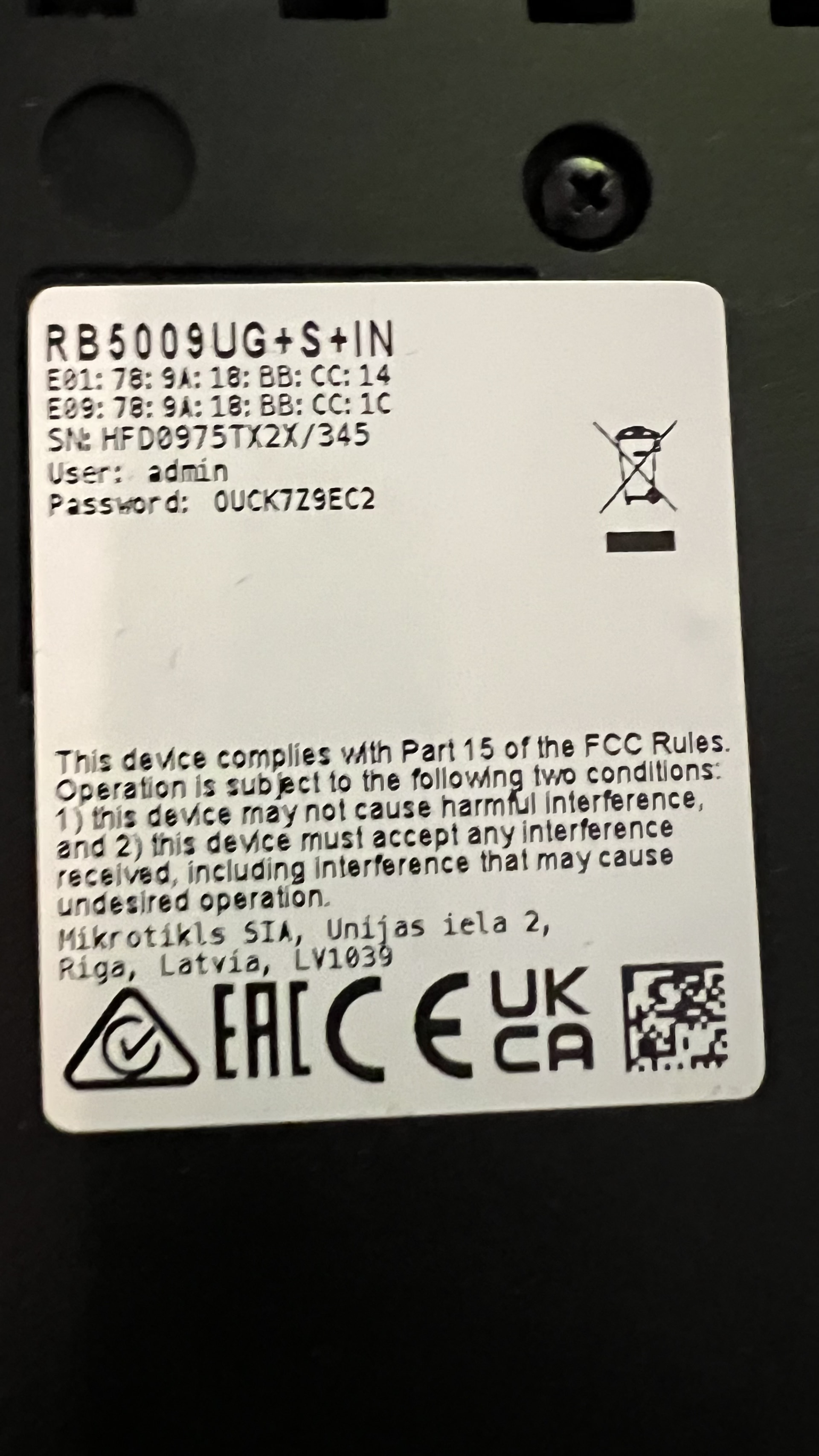

Hey, i bought a RB5009, which came with a sticker at the back and another one for keeping somewhere else.
I could not login, so i netinstalled it without config. Serial and MAC is from another device.
Here the stickers:
And the routerboard info:
What can I do? I really want the original password sticker, if i ever need to reset it or something else happens…

SN is also different?
Silly question:
For the first character, did you try both a capital o and a zero?
Normis once claimed they only use non-ambigious characters. But then, there is this 0 or O? Is the label different font families? RB5009 should be 2 zeros. But zeros should look like in the MAC or SN - with strikethru.

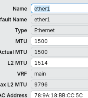

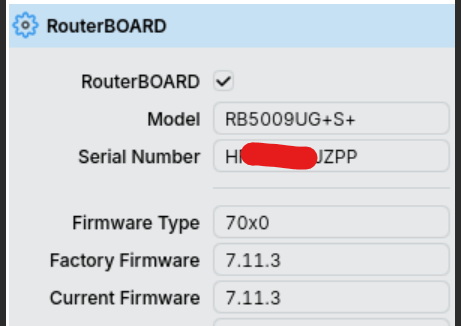

Yes, i posted the routerboard info screenshot. Its different
Yes, as i read in this forum. There is also another forum post, where the same thing happened: Default password sticker wrong! - #15 by zgv163
MAC and SN are different too, this is for sure the sticker for another device.
