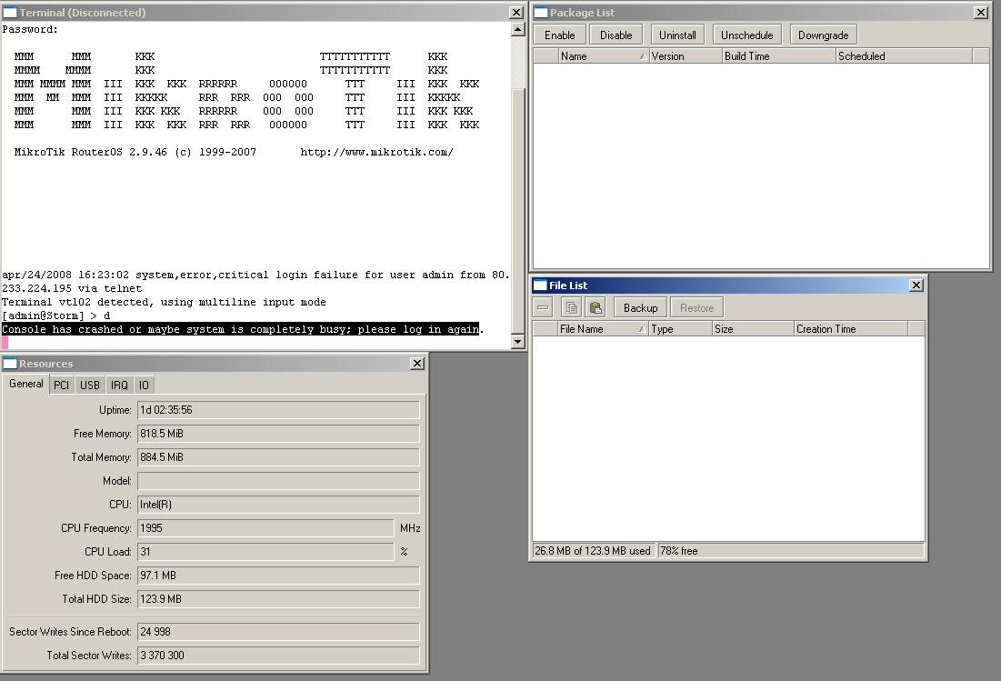

I have this very weird behavior of my ROS. Yesterday i have changed v3.1 to v3.7 on multicore intel processors and…thank you MT for almost giving me heartattack when my production router failed to start. Good thing i had backup flash with v2.946, so i put it in, traffic flow became normal again but i expirienced some bug with ‘New Terminal’ window saying that ‘concole is busy, try again later’ or something..but its wasnt even a problem to me cause i was so happy that production is working. Later on that day i have been working on some rules then closed winbow with ‘X’ and after that i couldnt login to that router again. Tryed different 100% worked before accounts , tryed to login from different PCs, tryed concole and everything gives me ‘wrong password and username’. Then i tryed to put login admin and blank password and it worked ! But all the accounts i had were deleted :neutral_face:
My questions are:
  1. WTF could happen to the users ? What about compromisin my security admin /w blank password ? No one exept me had full privelege password(too complex to brute, secure connection, strict ACL to get to router), router didnt loose power or nothing…
  2. What version is stable to use, if there is one :laughing: ?
  3. What about concole bug - ‘Console has crashed or maybe system is completely busy; please log in again’ ? Router resources are normal, but i dont see no packedges installed or nothing…how to fix that ?:slight_smile:

Hey, i’ve just noticed that package and files under winbox are empty too..
I do believe that such a thing has to be explained somehow or treated as a bug :frowning:
