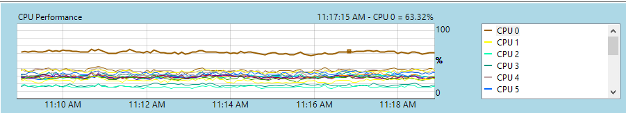

all this is proper but right now i am facing one issue that Ethernet is not using all core for load only using particular core
i am attaching pic please help me how to solve this
Load is only 30% on single core. Process is kept on single core as long as core is not fully loaded.

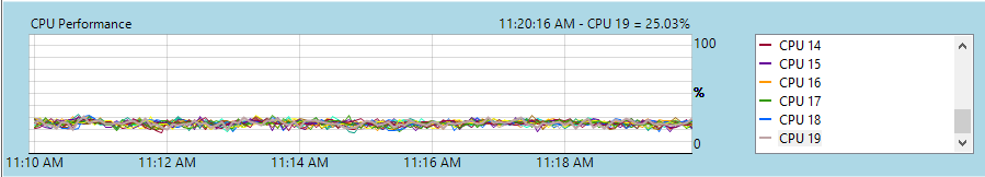

I’ve been trying to fix this same problem on my CHR, changing RPS settings, IRQs, interface-queues, without success.
XenCenter says the VM CPU usage is higher than I can see in ROS
But the CPU usage by the Xen itself is quite low
What can I do to make the CPU usage better?
