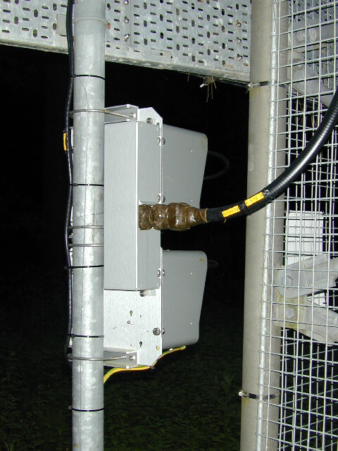

I am VERY talented with the (apparently tried and true) butyl taping method, but our connections started to get to close quarters and is horrible to do in -10f weather with 30mph winds. This method included a ‘courtesy wrap’ of high end 3m electrical tape, then the butyl, and the a perfect spiral of tape over the top.
The next method we tried and am currently using are the cold shrinks made by times, these are easy to install but at $30 a pop, they are expensive, and they dont fully seal down on lmr400, and finally the included butyl tape included in these make a complete mess of bulkheads.
