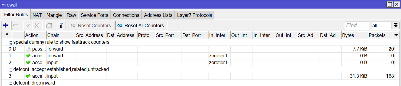

I know that. This is normal since there is no support for zerotier in winbox yet. If you check firewall rules in terminal they should be correct. In Winbox you see “unknown”.

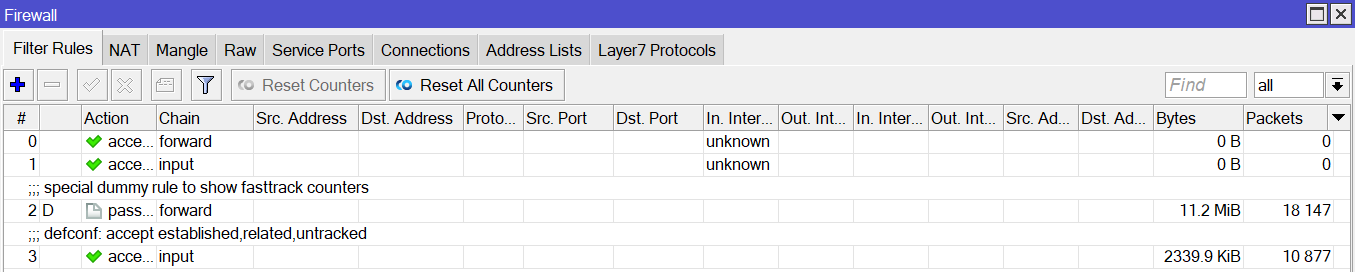

This is what I see after a few minutes.
The Zerotier interface is gone and repositioned with ether1 or unknow.
After a reboot the zerotier interface returns but not always.
As skylark told you, this is considered as normal for now. What problems to you have with traffic?

I have not had one problem with zerotier. If your on the firewall rule in winbox then you are going to mess the rule up, as zerotier is not supporteds on anything but CLI. To work around this problem for noww add zerotier1 to a interface list and use the interface list in the firewall rules, that way you can mess with the firewall rules all you want in winbox. just don’t touch the list now!

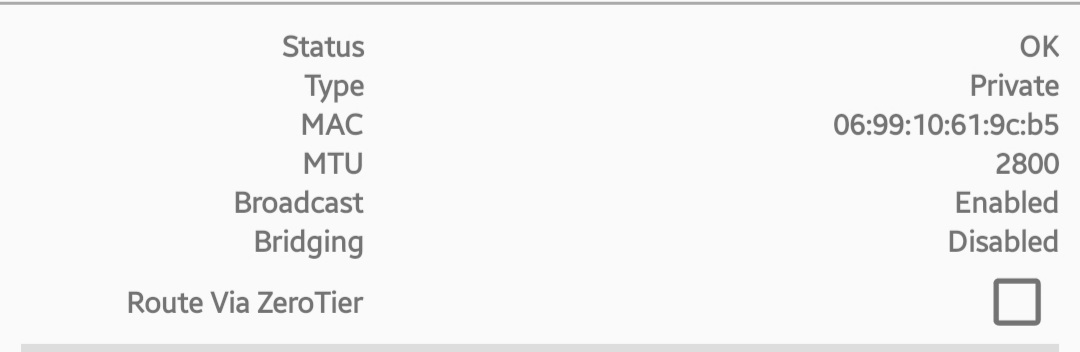

I added screenshot from ZT Android Client. There is one option - Route via ZT, but if I marked it was the same. Generally I am not such good in Mikrotik ROS, and generally in networks, so I think it will be “to high mountain” for me. But thx a lot for Your full answer.
Try adding route to 0.0.0.0/0 gateway “your Mikrotik IP in zerotier network” in Zerotier dasboard and then enable Route Via Zerotier. Not realy sure if this will work, but you can try.
BINGO! It is working! Thx a lot!
