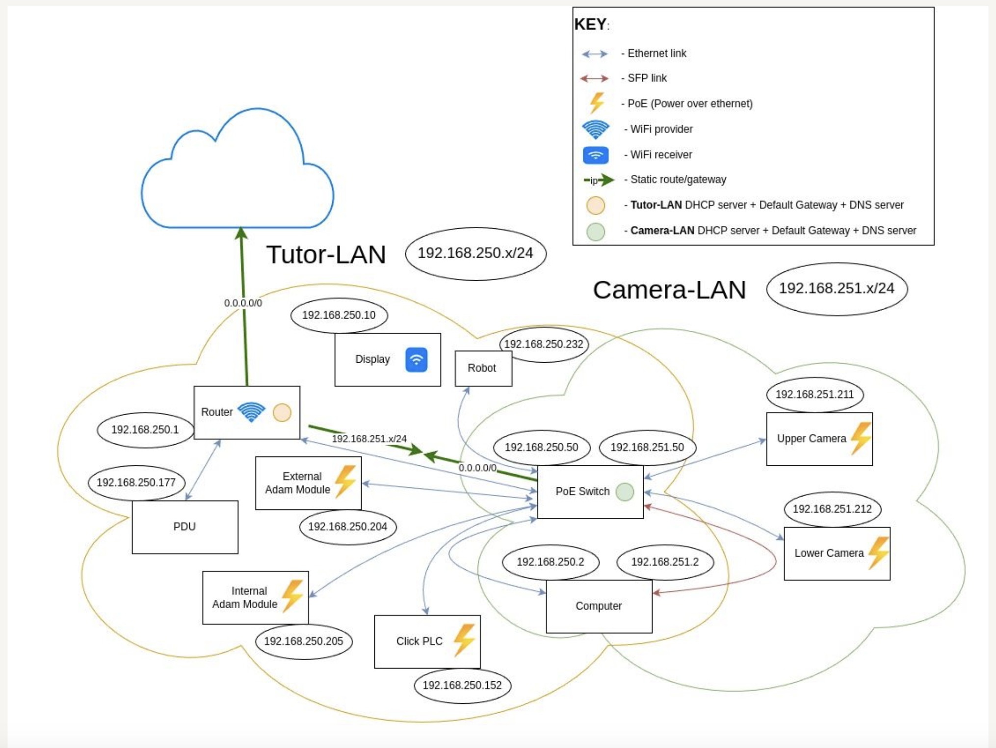

Network Topology:
LAN 1: 192.168.250.0/24 handles internal traffic between many of the components
LAN 2: 192.168.251.0/24 handles internal traffic between cameras and computer (according to camera documentation, these need to be on a dedicated network)
ZeroTier VPN network: 192.168.188.0/22
Azure tunnel server IP: 192.168.188.1

So I think I didn’t communicate the situation all that well. The LANs 1 and 2 are only internal to each robot network. These allow us to use consistent IP addresses for each device across robots. For example, all robot computers have the same IP address but each is remotely accessible through the dedicated router ZeroTier interface along with a port forwarding rule. The internal devices can reach the internet through a masquerade dst NAT rule from the router. The Azure server can reach each device through the ZeroTier IP and the corresponding NAT port. I’m not sure this changes the configuration steps you gave me though. Intuitively, these still should work. Will try this now!

I’m having trouble wrapping my head around this sentence: “These allow us to use consistent IP addresses for each device across robots. For example, all robot computers have the same IP address but each is remotely accessible through the dedicated router ZeroTier interface along with a port forwarding rule.”
Are you using the same subnet at all sites for LAN1 and LAN2, i.e. 192.168.250/251? If 192.168.188.1 isn’t a central exit node to the internet but is used for something else why the need for 0.0.0.0/0? Are there other subnets behind LAN1/2?
To get a better picture of the whole thing, perhaps you could expand the previous Network Topology with an example of two different sites, each with a couple of node addresses on LAN1/LAN2, and how they need to communicate with some service on a network behind 192.168.188.1 (or vice-versa).
That what confused me too. I think… there is a ZT member at Azure to act as an internet gateway & idea is the “robot router” send everything but ZT tunnel themselves via that. I get using ZT address to act as a “global LAN” IP address for the device doing port forwarding part.
We are not using routers for the standard “router” use-cases. Each robot we deploy requires a significant number of networked components for operation. For example, a computer, robot control box, PDU, managed switch, etc. are all put in a server box next to the robot arm. Along with all of this equipment, we install a MikroTik router inside the box to handle the networking between these devices, direct access into the internal network for debugging purposes, etc. ZeroTier mixed with port forwarding gives us remote access to this equipment. The 192.168.250.0/24 and 192.168.251.0/24 LAN’s are the internal router LANs. This allows us to use static IP’s while communicating between devices within the server box’s network and static port forwarding.
