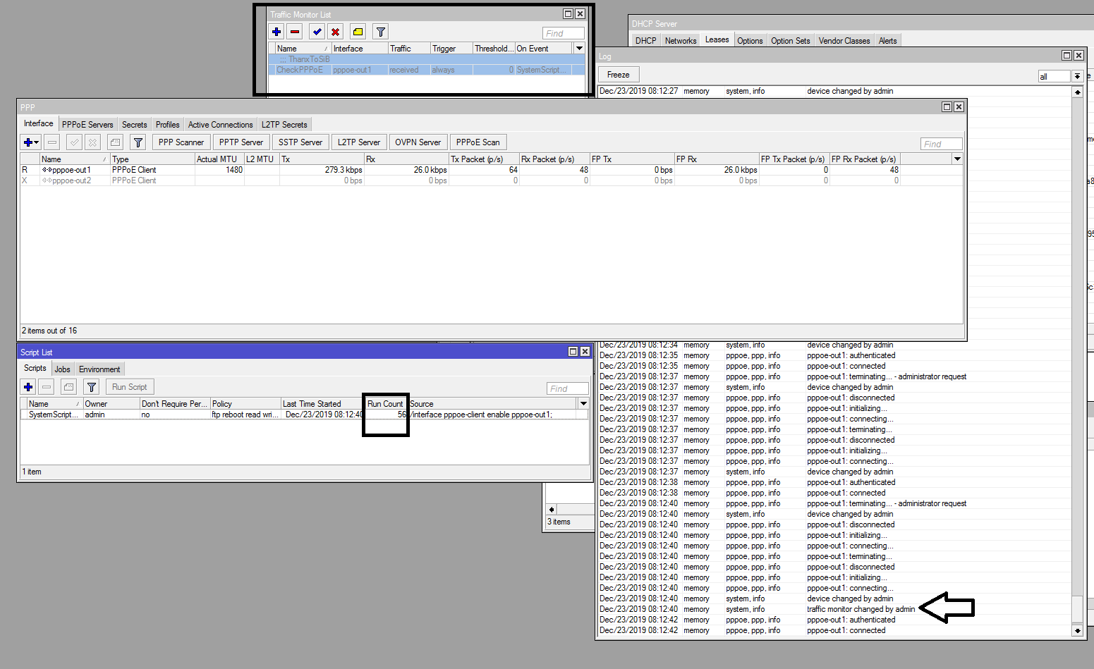

Tested. When the threshold 0, the trigger hit run time 298 times, until I disable the script, re-enable manually and the pppoe connected and back to normal. Any advice please?
Again happened this morning
Single/One pppoe with ISP in standard situation newer reach 0 and the traffic monitor is good idea to check if problem exist.
You situation I think is other. When you not have a “big transfer” as normal traffic then you should change a checking way. Before, I answer you a generic information to generic question.
This mean the 0 at Rx is your normal behavior and you not gave many traffic/customers behind your device and then TrafficMonitor generate 298 fail-possitive check’s I assume.

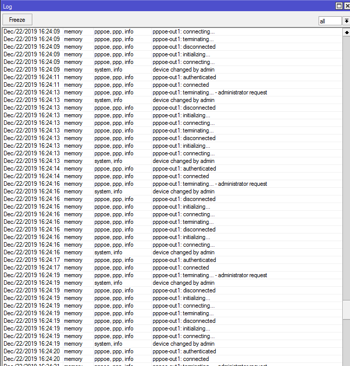

Re-enable TrafficMonitor script or ppppoe interface?
I think the pppoe interface - this means the TrafficMonitor generate failse possitive re-enable and ROS cannot do connection?
Maybe the proper way to re-enabled in ROS is disable and separate enable the pppoe interface to do re-connection.

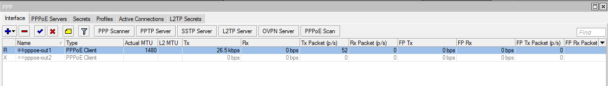

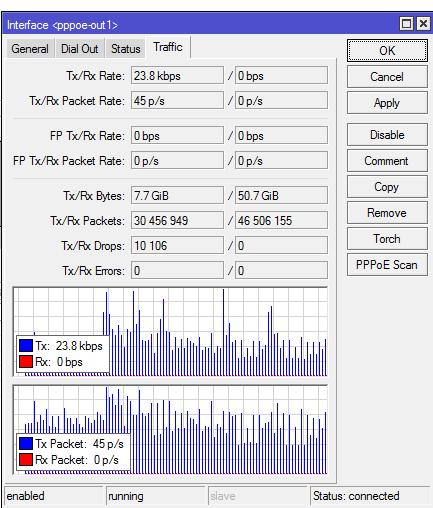

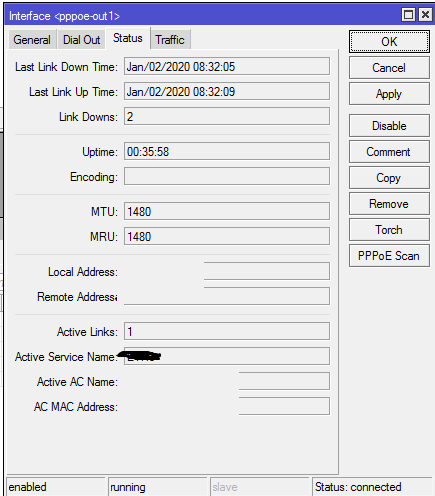

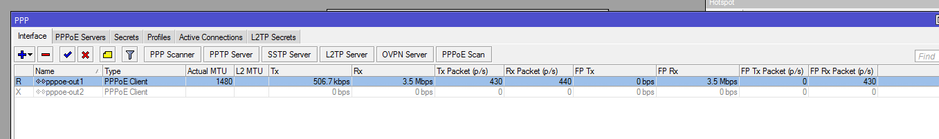

My situation the PPPoE Status (Connected) and FP Rx 0 OR Rx 0, when i served internet there is no internet until I Disable and Re-enable PPPoE account, What I’m looking for If I got the FP Rx 0 or Rx 0 Then the Script or built-in configuration disconnect the PPPoE account and enable. Appreciate your support in advance my friend.
Yes I think of that, Rx 0, I try to navigate to youtube or any website to have transfer and see if it changed from 0, All my tries failed. The only way disable the PPPoE account and enable it again to have the internet back
I don’t know why the TrafficMonitor generate that big failed check, I just Disable the TM to avoid disconnect-Connect fail request and as usual disable the account and enable it manually.

You have internet only from pppoe-out1 and when it’s have Rx=0 and Tx=0 then what is a status of this connection?

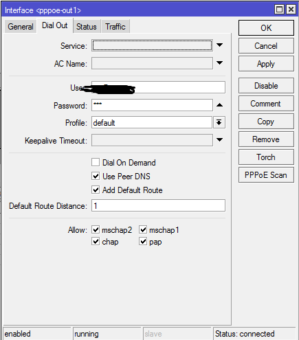

Provide me a cli print without login/pass:
interface pppoe-client print detail
put [interface pppoe-client monitor pppoe-out1 once as-value ]
and/or screenshot from Status tab.
We can connect TrafficMonitor with one of those status infrormation to do proper checking and restarting pppoe.
Alternative will be scheduler and netwatch since.
status connection
And main question. In Status Tab is a different value when internet is online?
I know Rx=0 but I search some additional who is other in offline and online mode.
Alaqmar12121
But you not share both screenshot to compare.
In this scenario, with all screenshot you provide I think that the best ways will be for you use from Netwatch+Scheduler to monitor internet and do reconnection when off-line will be x minutes.

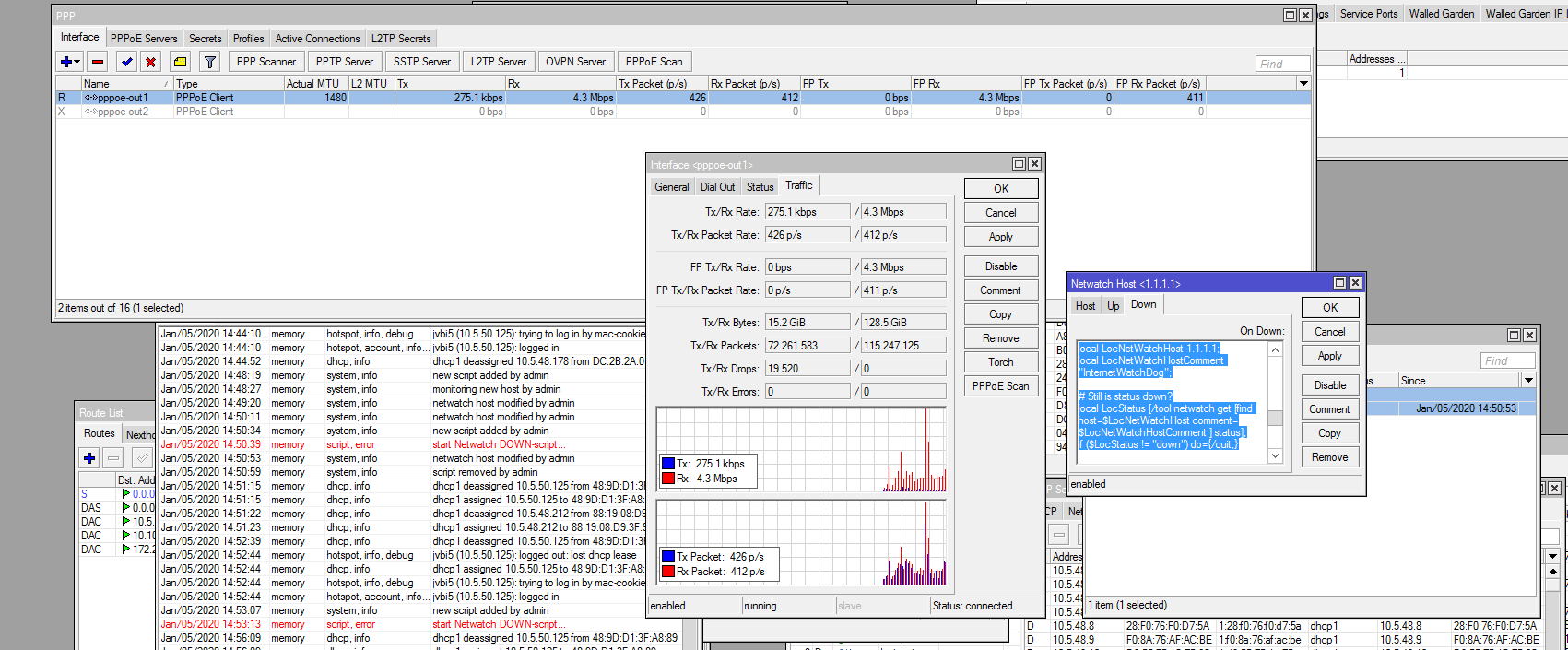

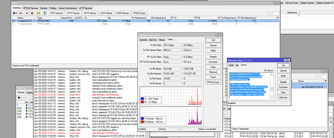

Can we just ignore the rebooting please? Just want to Disable the pppoe and enable it after 25 second
WinBox > Tools > NetWatch - here a place with 3 tabs, up and down tab are two script who are running when access to remote host change to up (work) or down (failure).
Host 1.1.1.1 and Comment are important because they are use to check a result of proper netwatch.
Please setup Netwatch to 00:00:05 (check 1.1.1.1 every 5s).
In Down-script, the action “after 20 second do reconnection” without reboot, this will be done in 20-25s from internet failure.

# Select a proper Netwatch who is ENABLE and have:
local LocNetWatchHost 1.1.1.1;
local LocNetWatchHostComment "InternetWatchDog";
# Still is status down?
local LocStatus [/tool netwatch get [find host=$LocNetWatchHost comment=$LocNetWatchHostComment disabled=no] status];
if ($LocStatus != "down") do={/quit;}
# Convert the Netwatch SINCE to separate date and time of current down-time.
local LocSince  [/tool netwatch get [find host=$LocNetWatchHost comment=$LocNetWatchHostComment status=down disabled=no] since];
local LocSinceDate ([/pick $LocSince 0 11]);
local LocSinceTime ([/pick $LocSince 12 20]);
# Add action to future via scheduler
/system scheduler remove [find where name~"SiBexInternetWatchDog_v"];
# Try MAIN ACTION 1 - PPPoE ReEnable after 20s
local SiBCrossMid [$SiBFixDateTime $LocSinceDate $LocSinceTime 20s ];
local SiBStartDate [pick $SiBCrossMid 0 11];
local SiBStartTime [pick $SiBCrossMid 12 20];
/system scheduler add name=SiBexInternetWatchDog_v1 on-event={/interface pppoe-client disable pppoe-out1; /interface pppoe-client enable pppoe-out1;} start-date=$SiBStartDate start-time=$SiBStartTime;
log error "stop Netwatch DOWN-script, Future action are scheduled";
Tried to understand something out of this “issues” but I just don’t get it.
What is the initial issue?
The FP Tx = 0 ?
That’s normal.
While connected to a router which is mostly idle, from outside.:
/interface monitor-traffic ppp-wan once
rx-packets-per-second: 8
rx-bits-per-second: 5.2kbps
fp-rx-packets-per-second: 8
fp-rx-bits-per-second: 5.2kbps
rx-drops-per-second: 0
rx-errors-per-second: 0
tx-packets-per-second: 11
tx-bits-per-second: 101.3kbps
fp-tx-packets-per-second: 0
fp-tx-bits-per-second: 0bps
tx-drops-per-second: 0
tx-queue-drops-per-second: 0
tx-errors-per-second: 0
And after beeing connected also to a device behind it so the firewall has to forward a few packets:
rx-packets-per-second: 15
rx-bits-per-second: 9.8kbps
fp-rx-packets-per-second: 15
fp-rx-bits-per-second: 9.8kbps
tx-packets-per-second: 18
tx-bits-per-second: 166.4kbps
fp-tx-packets-per-second: 5
fp-tx-bits-per-second: 54.2kbps
No issue.
ppp-wan wasn’t reconnected since boot. (link downs = 0).
