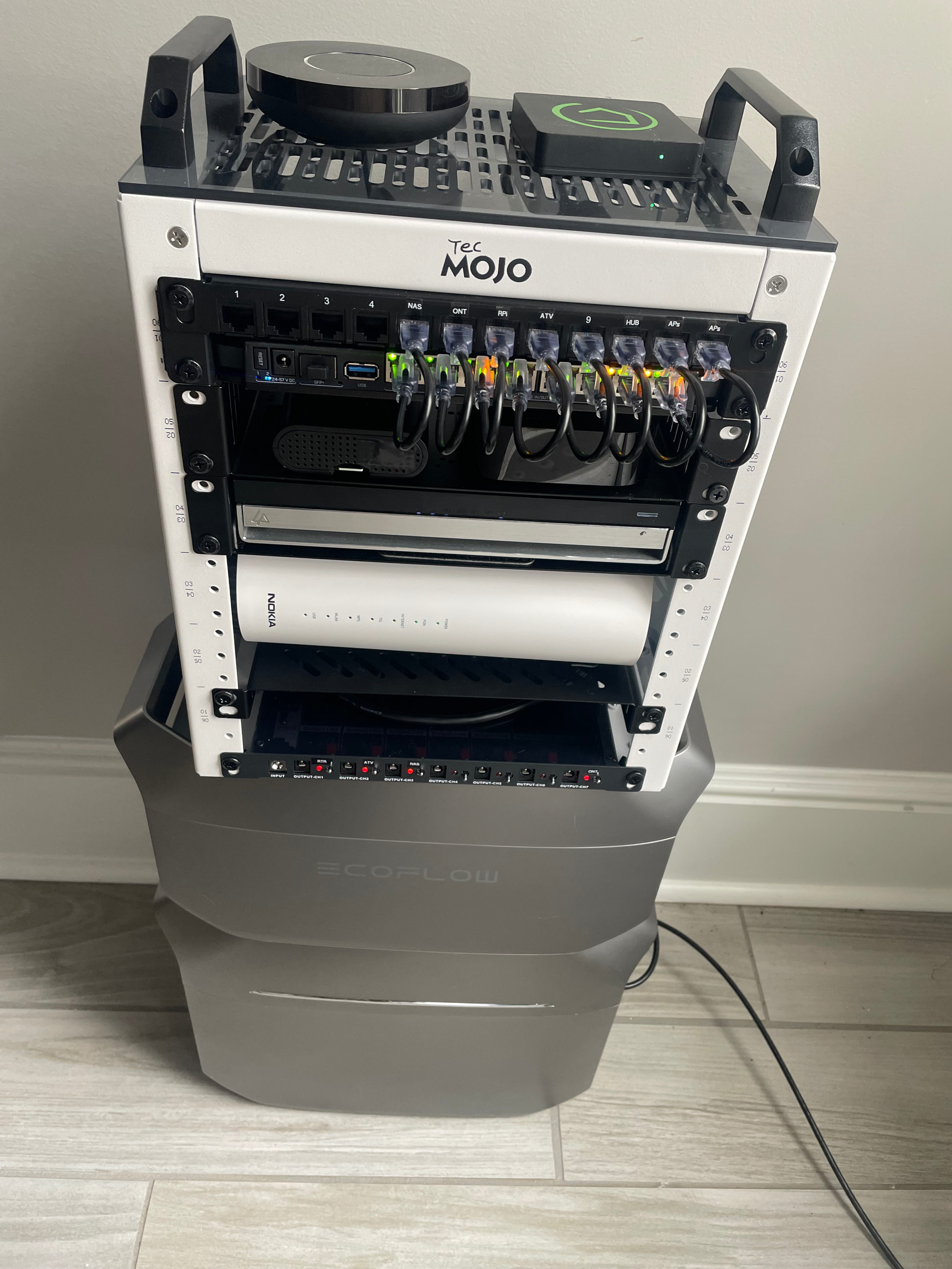

It fits, I just left the silver screws on the side rails a bit loose, fitted the 5009 with its rack ears into the rack, it's a tight fit, and then just tighten the rails. There's just enough slack.
This is my DC powered and silent homelab rack, Gigabit internet ONT, 48TB SSD NAS, no fans and draws around 60W.
Nice !
That's an Ecoflow with supplementary battery I see below ? Delta 3+ ?
Yes, at the time of the photo it was all running from the Ecoflow's 12V DC port, using a 12-48 boost converter for the RB5009, but I have since removed the extension battery and added a 100Ah 48V server rack battery (using the WattCycle Ecoflow cable) and switched the rack to 48V DC, with a 48-12 converter for the 12v items. It now draws even less power. Runs for about a week.
