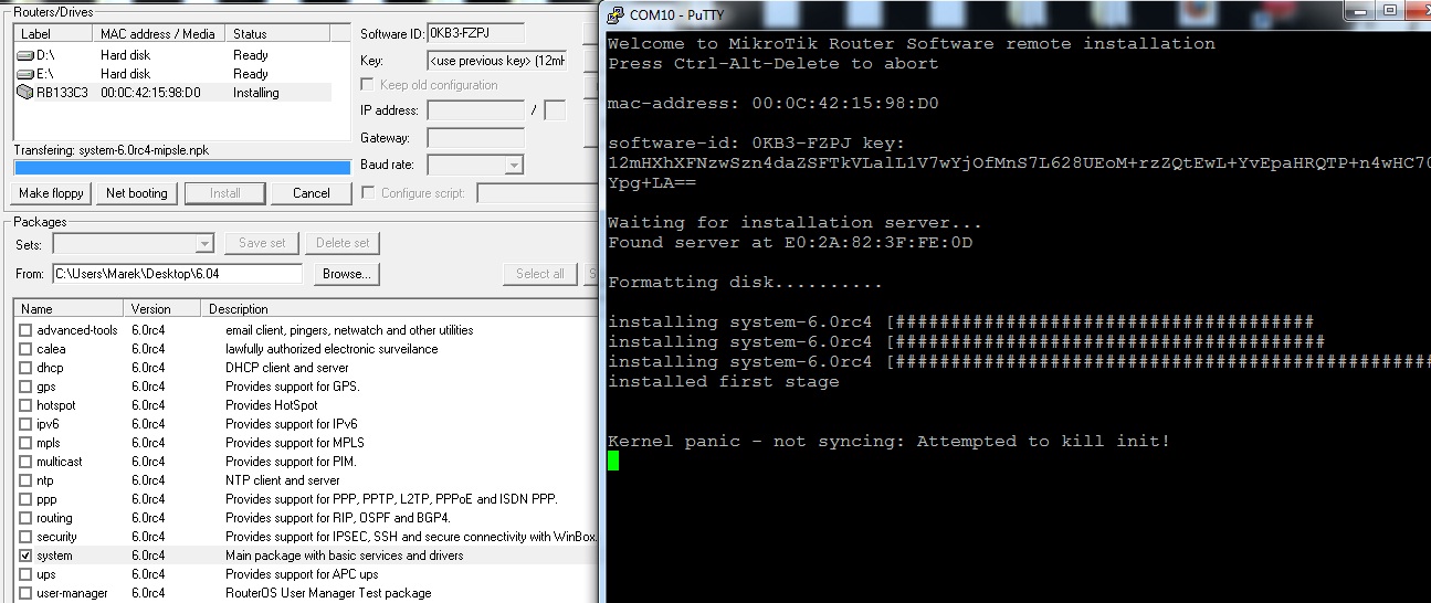

  • Do you have the same problems with Winbox? - Yes
  • 6.0rc4 Netinstall? Have you tried different computer? - Not yet, but netinstall of 6.0rc3 and 5.22 work perfectly

what kind of configuration you have? as we tested RB800 with R52nM card and it is working fine with 6000mhz HT below.
nz_monkey
I have used Netinstall 6.0rc4 from download page and RB751U, Netinstall worked without any problems.
Do you have any other RB751U for tests?
And we need to repeat console crash somehow, if it is not possible to make support output file, probably you can provide us with instructions and steps, how to simulate the same issue you had.
R52nM and SR71-A use different chips.
R52nM - ar9220
SR71-A - AR9160
The other side didn’t connect on 6000 so I changed it to 4800 and after that nothing could be changed at all.
Everything I tried to do on the wireless card or even downgrade caused kernel failure.
I have sent autosupout after that from my company mail.
RB800 6.0rc4 kernel failure as subject.
Check it out.
I try install only system package on rb133c
