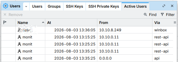

The REST-API "stuck-user-problem" seems still not solved:
For now,

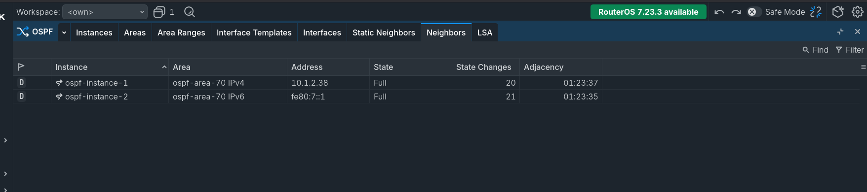

Updates a CRS520-4XS-16XQ from 7.23.2 to 7.23.3. Update itself was smooth, but after restart establishing OSPF sessions seems to be a bit slow initially.
The neighbor tab in the OSPF windows also does not show any neighbor, even after sessions have been established. There are visible via CLI nonetheless.

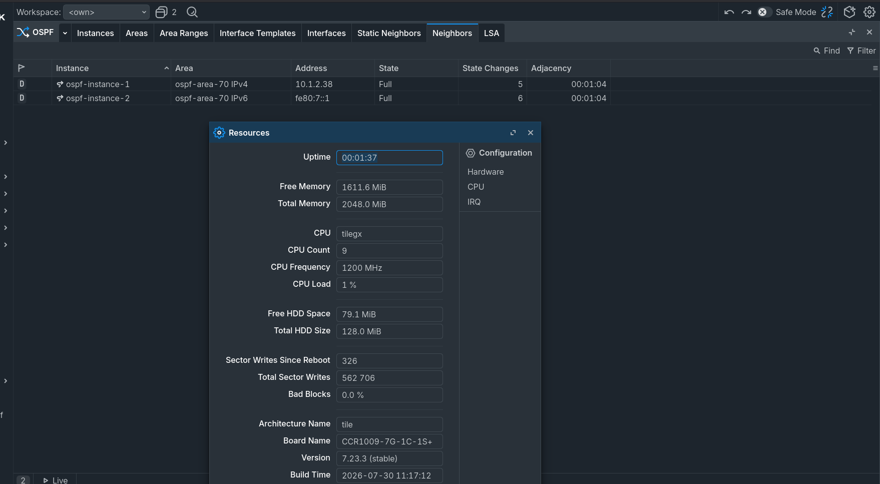

Hi, we updated a CCR1009 router a few minutes ago. Here are before and after pictures. No problems or delays with OSPF. Everything is working correctly.
