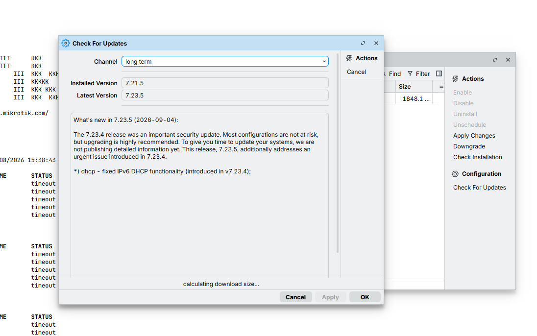

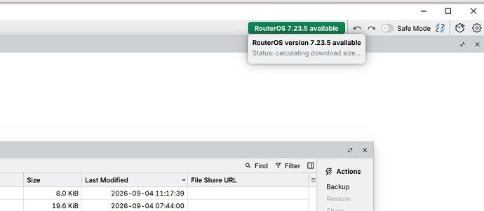

I am facing many difficulties trying to upgrade. Maybe it is just me, but maybe it helps:
calculating download size lasts forever. It does not do anything further.
same here.
I tried dowloading it and rebooting. It did not work either.
I tried android app as well... Did not work either.
My device is rb4011igs+rm

Which version are you trying to update from?
7.21.5 according to screenshot.
Hm, you're having issues downloading the packages.
My device storage is full ? How do I check that ?
Maybe this issue: Firmware downloads are slow and often fail
