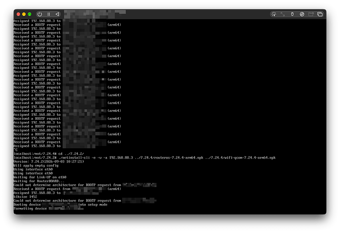

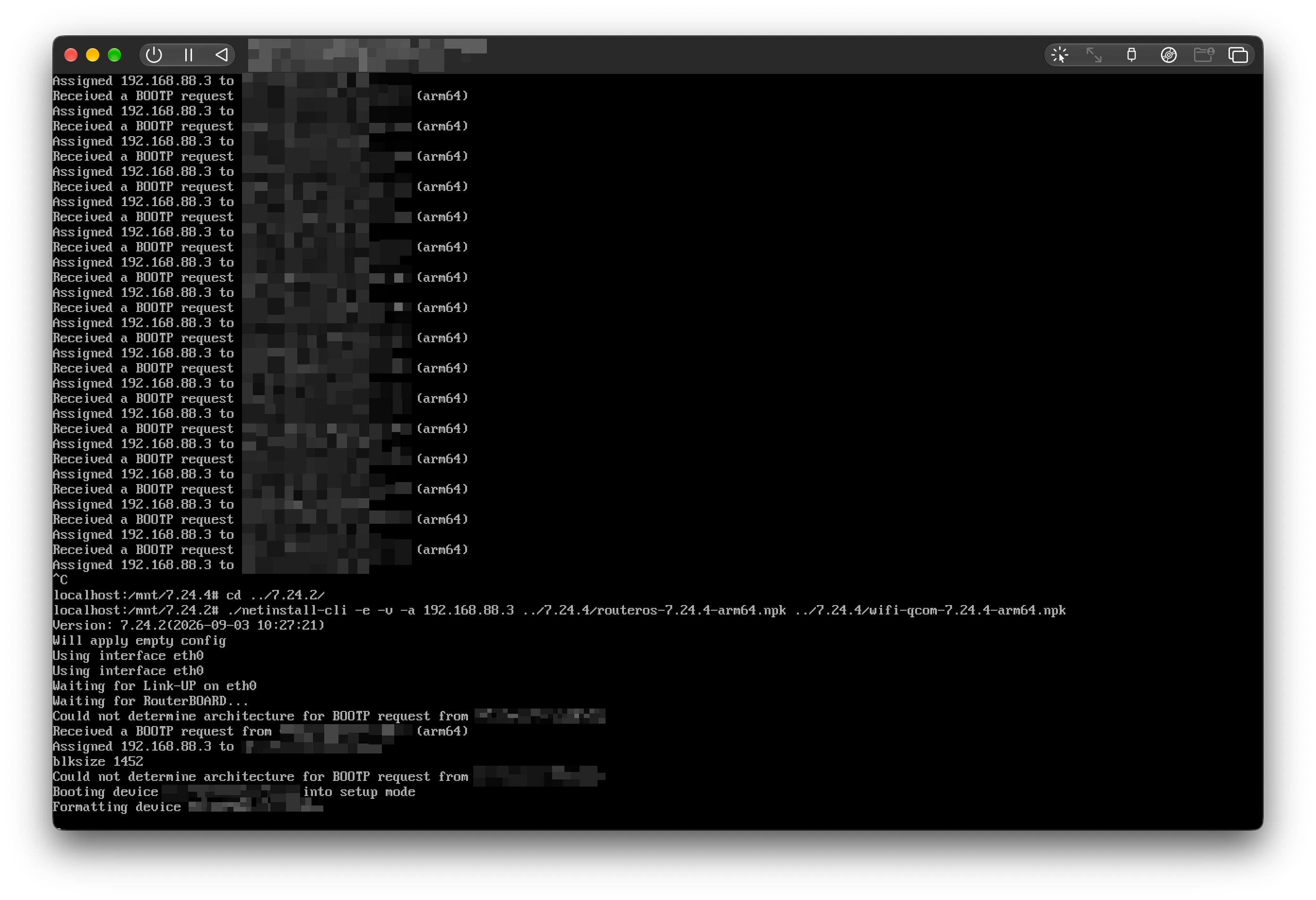

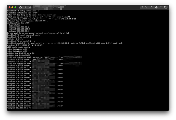

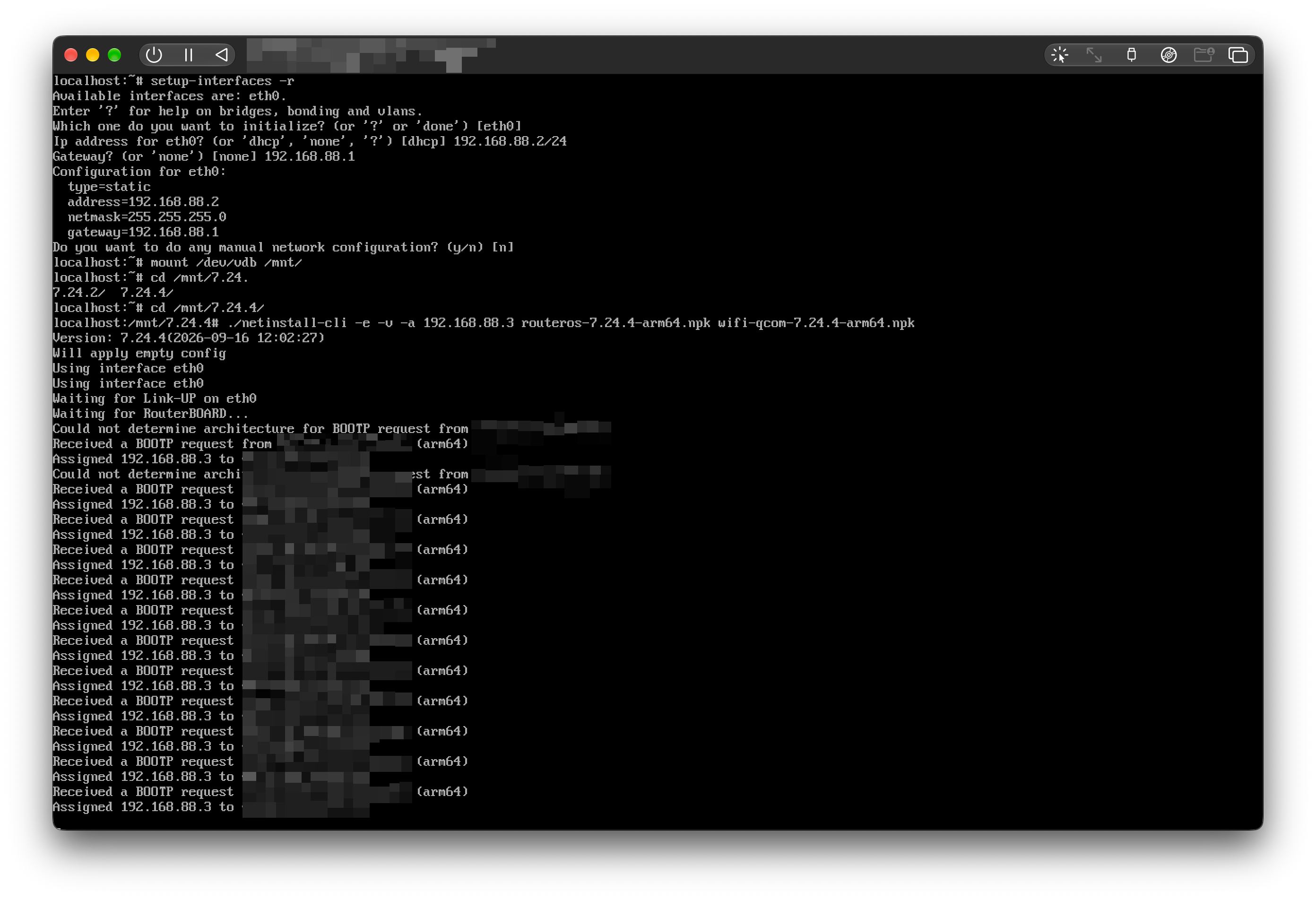

Environment / Configuration:
OS: Linux (localhost)
Interface: eth0 (192.168.88.2/24, Gateway 192.168.88.1)
Packages: routeros-7.24.4-arm64.npk, wifi-qcom-7.24.4-arm64.npk
Target IP: 192.168.88.3
Description:
There is a regression in netinstall-cli version 7.24.4. The utility continuously loops on receiving BOOTP requests and re-assigning the IP address without proceeding to the installation phase. Reverting to version 7.24.2 using the exact same arguments and package files resolves the issue — the tool negotiates the block size (blksize 1452), boots the device into setup mode, and starts formatting.
Conclusion:
netinstall-cli v7.24.4 breaks the BOOTP/TFTP handshaking process for arm64 architecture, preventing the client device from negotiating blksize and entering setup mode.
Hmm, interesting find. I think I experienced this as well, but put it down to just something I wasnt getting right, and moved on.
In my case I was running a windows system and used the netinstall x64 v7.23.5 UI version and had a similar issue.
Device: RB3011uias-RM running latest LTS (at that time 7.23.5)
Symptom: It showed on the LCD that it was in the ether boot stage, but it never displayed in the netinstall UI. Same setup, no changes, but used a Hap^ac2 (on an older version RouterOS though) and it showed in the netinstall UI and I was able to netinstall it, no problem.
I know it can be a bit hit or miss on windows with multiple interfaces (but I do disable the other interfaces during a netinstall to help solve that, which works well most times) but I thought it was just one of those moments and didnt take more notice of it until now.
Exactly. It’s deeply frustrating when updates break low-level critical subsystems like TFTP/BOOTP without a single line in the changelog.
Having personally submitted multiple bug reports for critical components like IKEv2 and certificates in the past, seeing these fundamental layers break is the final straw. It really puts recent security incidents into perspective.
