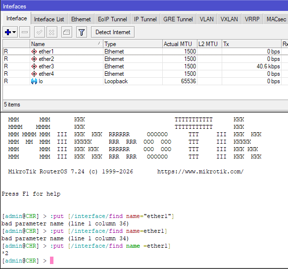

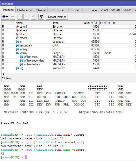

At this point it could be the name of some interface that influences the result,
maybe some character outside of ascii-7 or some unicode character that ruins everything...
EDIT: not

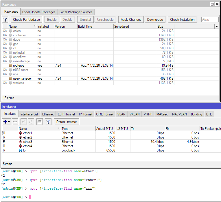

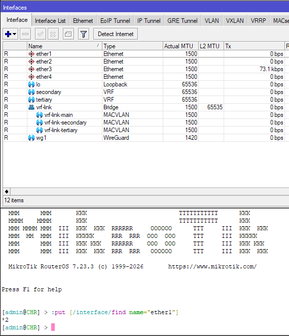

I took a blank CHR and reset the configuration to be sure and it still has the bug:
Here is another disk image with the name of interfaces, where it works with 7.23.3:
And that same installation with the same interfaces after being upgraded to 7.24:
Why are you doing this?
It never even occurred to me to question what you wrote.
Unless I misunderstood what you meant, and I apologize in advance.
Because you wondered about whether some interface names might be the cause, so I reset a CHR to default configuration so that the interfaces names are only ether1-4 and lo :slight_smile:

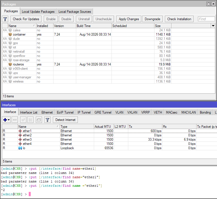

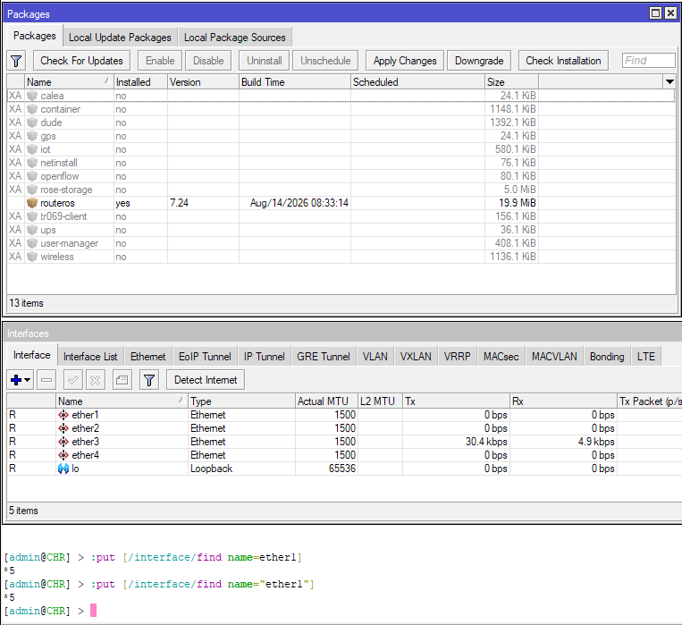

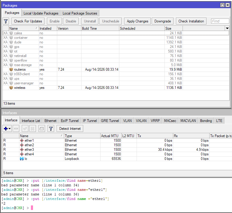

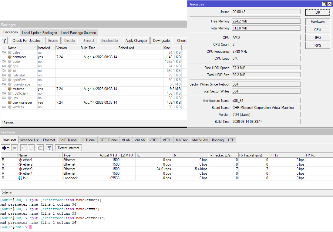

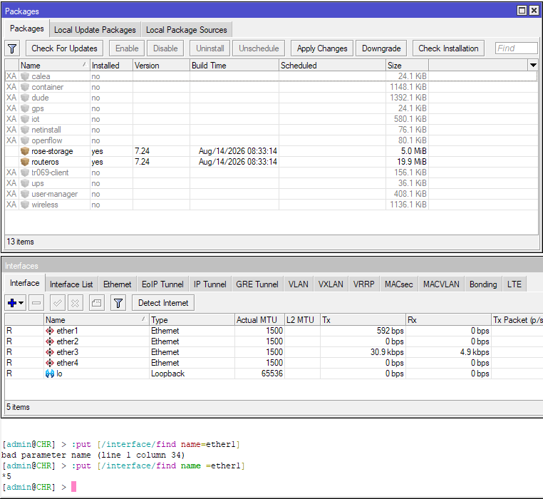

I did more tests and it does depend on the package installed! For the following tests, every time a package has been added / removed, a full Reset Configuration with No Default Configuration is performed:
CHR with base routeros package and rose-storage -> Bug present!
Removed rose-storage -> NO BUG!
Enabled container -> Bug is there again!
Removed container and enabled wireless -> Same bug!
Back to only base package -> BUG GONE!

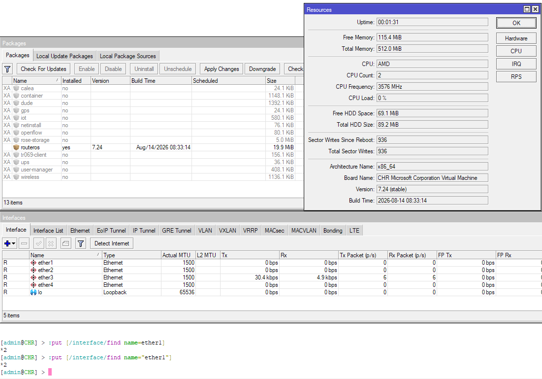

Note: This screenshot also has the VM details. It's running under Hyper-V.

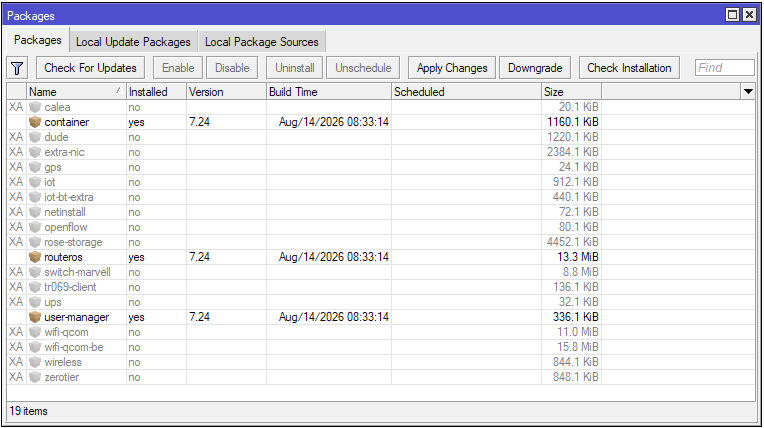

Added user-manager package -> STILL NO BUG!
Enabled container beside user-manager -> Bug's back!
My RB5009 has these packages, can you try enabling container on yours?

On D53G-5HacD2HnD (arm) with routeros,container,netinstall the issue is not reproducible. Is this an isolated arm64 container package issue?
