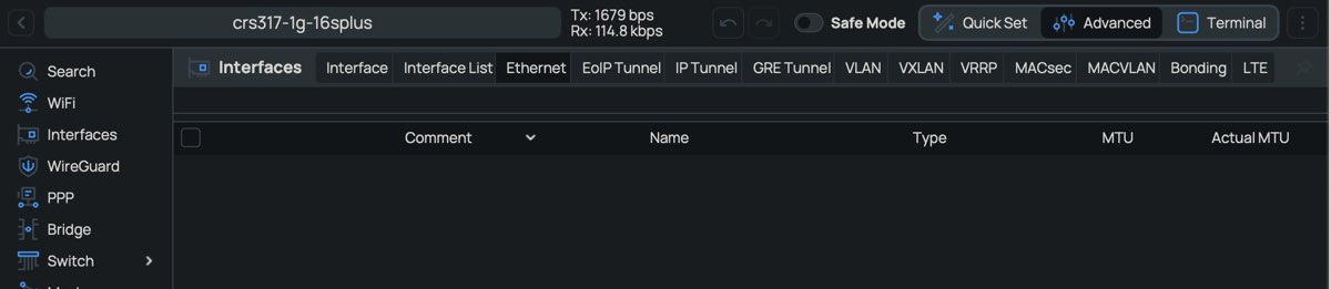

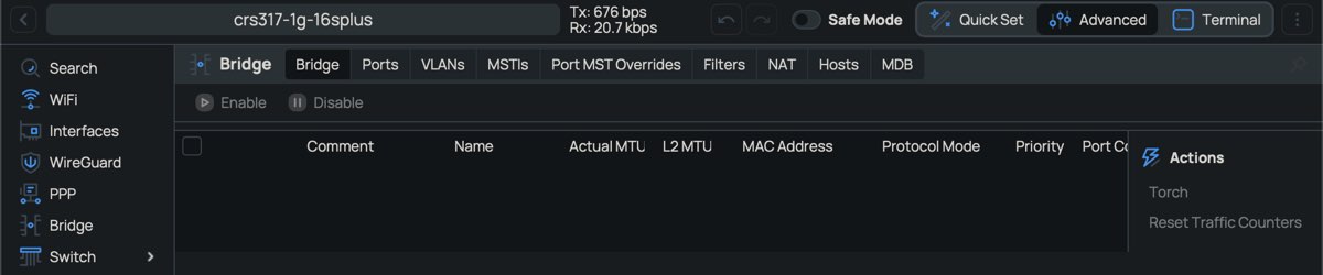

I'm running 7.25beta4 on a CRS317 and the list under Interface > Ethernet and under Bridge > Bridge is empty.
I tried with Firefox and Arc (Chrome Engine) and Safari on macOS 15.7.9, all showing the same. Additionally I also tested it with Firefox and Vivaldi on Linux Mint 22.3 with the same result. Also with the browser I tried private mode without success.
WinBox 4.4 show all interfaces/bridge, as does the CLI.
Does anyone else have the same issue, on a CRS317 or another device?

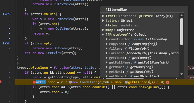

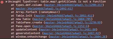

It's a Javascript error:
The table.map property for this Bridge table is a FilteredMap instance instead of ObjectMap and thus doesn't have the getAllConds() method.
Impressive! You do the job for MT :slight_smile: , shall I add that to the ticket?
