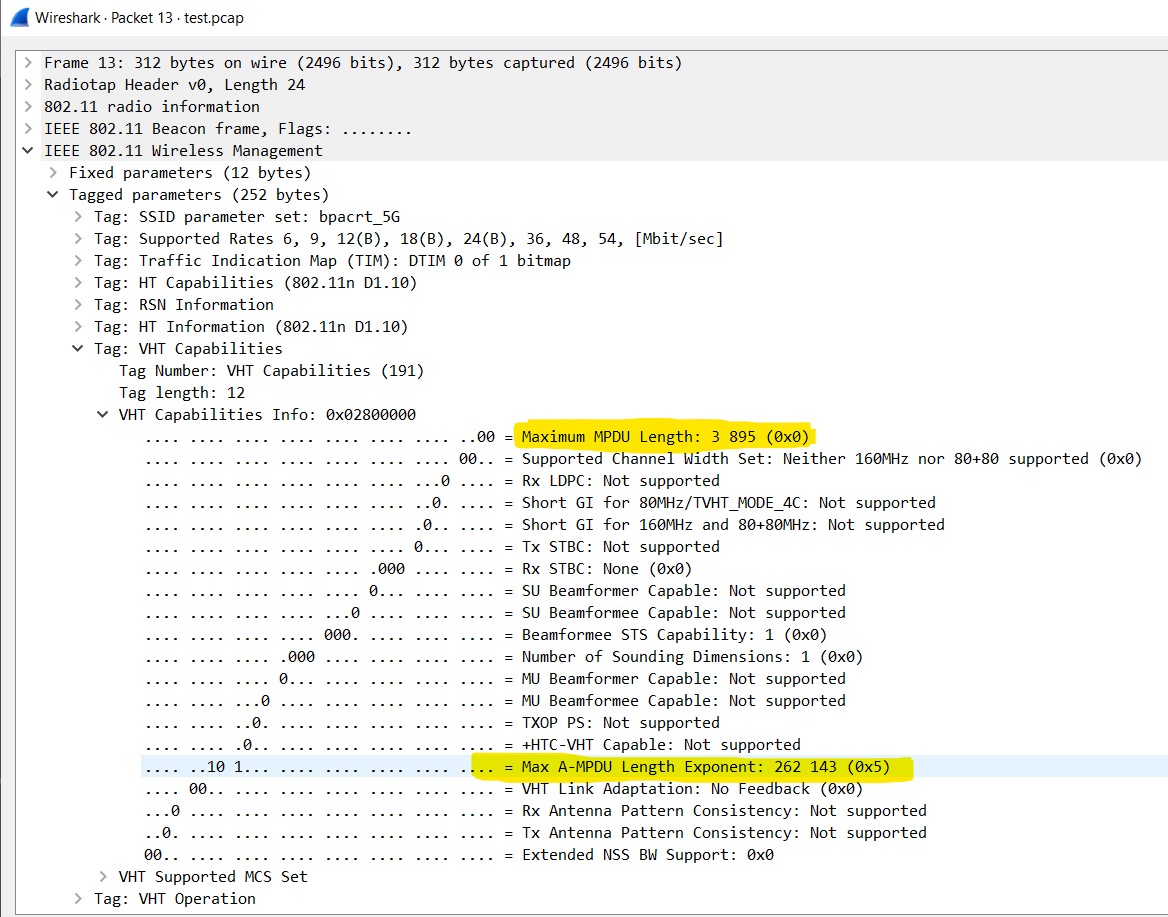

Well that was the indepth analysis of what is (assumed to be) going on. It is partly reverse engineering (the 8 MPDU in one A-MPDU is just using numbers to have the measured values)
Some of it is defined. Like the supported max MDPU and A-MPDU are broadcast by the AP 10 times per second. And Mikrotik uses the low values of the 802.11 standard.
There is nothing we can do about this in RouterOS. Well I have no idea how to set this in MT. There is also no feedback on aggregation used.
What can be learned from this are a confirmation of the data rate numbers measured (Mikrotik)
400Mbps-40MHz/2S/SGI can deliver 260 Mbps as data rate. This will be reduced by the environment. (retransmits, busy airtime, noise, destructive interference), and due to waiting for a clear transmit channel.
800Mbps-80MHz/3S/SGI goes up to 360 Mbps. Again with reductions as above
1300Mbps-80MHz/3S/SGI goes even higher, but I have no measurements, as I have no client devices that support 3 streams.
Improvements that can be made are small. Higher basic rates if condtions are very good is one.
Changing software (wifiwave2, OpenWRT, other vendor …) will use bigger MPDU and A-MPDU, and this delivers more data for the same interface rate.
Possible values for MPDU and A-MPDU are in the 802.1 standards.
Packets are combined into MSDU, → aggregated into A-MSDU what is the payload for the MPDU, → that agregates into A-MPDU.
What the AMSDU parameter setting does in Mikrotik is not documented. The MPDU used is 3895. Corresponding A-MSDU is 3839 (for 802.11n next value is 7935, 802.11ac also has 11462)
But how could 8192 or a higher than 3839bytes AMSDU size fit in that MPDU ? Lower value will probably reduce the size transmitted. AMSDU=8192 does not alter the MPDU size used.
Using WMM with A-MPDU disabled will give small packet delays (no buffering) but much lower throughput. Enabling and using WMM on Mikrotik is not that simple.
