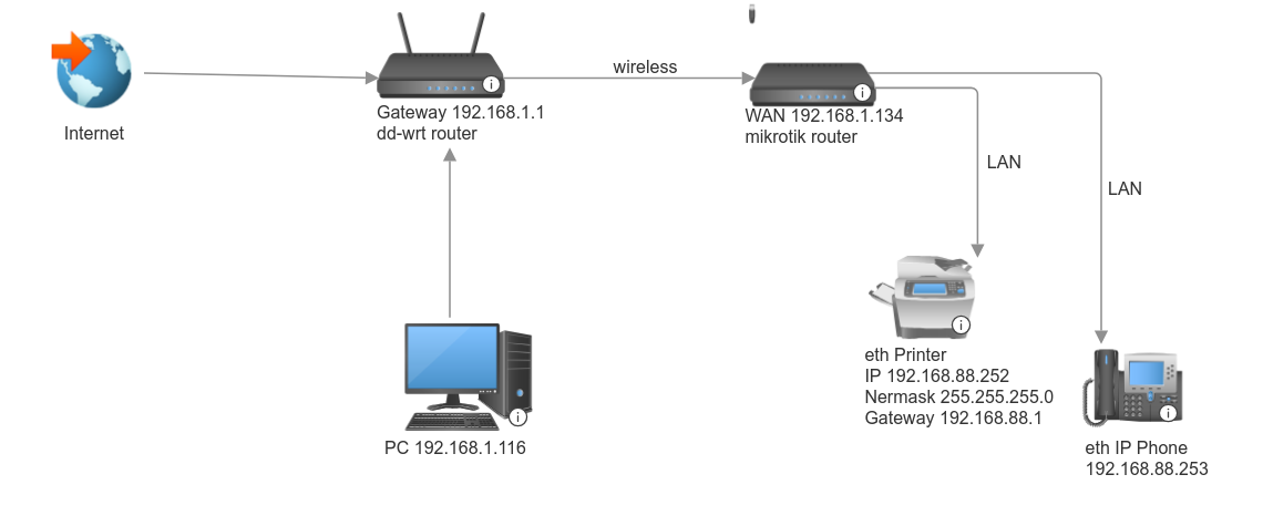

My network diagram:

The main consideration, following traffic flow, is how does your dd-wrt router know that any traffic headed for 192.168.88.x should be routed through 192.168.1.134, vice out the WAN port to the internet?? Once you are able to set a static route on the dd-wrt, I am sure your firewall rules will work out with some modification, in interface is NOT the bridge!!

The IP address of the MT router on the ISP LAN, ( the WANIP of the MT Router) is 192.168.1.134
The IP address of the device on the ISP LAN wishing access to the pinter on the MT LAN is 192.168.1.116.

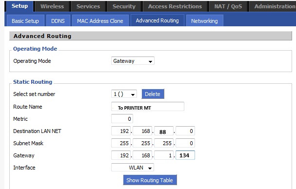

The right approach I was thinking of was a simple static route on the dd-wrt router.
add dst-address=192.168.88.0/24 gateway=192.168.1.134
DONE!
Now the traffic will land at the MT router coming in on the WAN side.
Simple forward chain rule should sufffice.

Rudimentary analysis shows that dd-wrt can do static DHCP → https://forum.dd-wrt.com/wiki/index.php/Static_DHCP
As well as static routes → https://forum.dd-wrt.com/wiki/index.php/Linking_Subnets_with_Static_Routes
So as I thought all the OP has to do is create the static route.
Then create the firewall rule.
add chain=forward action=accept comment=“ISP LAN user to printer” in-interface-list=WAN src-address=192.168.1.116 dst-address=192.168.88.252

Thanks Anav. Your solution works.
  1. ip route add 192.168.88.0/24 via 192.168.1.134
  2. add chain=forward action=accept comment=“ISP LAN user to printer” in-interface-list=WAN src-address=192.168.1.0/24 dst-address=192.168.88.252
  3. succesful ping and print to 192.168.88.252
The only thing I had to consider is to put the new firewall rule before the rule “defconf: drop all from WAN not DSTNAted”.
