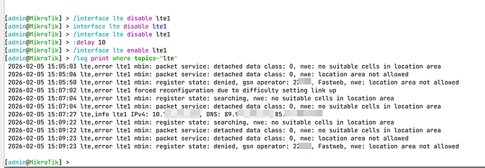

Ok, I prepared a small step-by-step plan before going to the mountain site, just to verify in practice what was suggested.
I’m not an expert, so I also wrote down the commands, please let me know if this approach makes sense.
:one: Check the log before doing anything
  • GUI (WinBox / WebFig)
    → Log
  • Terminal
/log print
To see only the latest entries:
/log print without-paging
Useful filters:
/log print where topics~"lte"
/log print where message~"error"
/log print where message~"warning"
The goal is to see if there is any message explaining why the connection stopped.
:two: “Clean” LTE reset (first choice)
:warning: NO reboot
:warning: NO PoE power-cycle
First, identify the LTE interface:
/interface lte print
(usually lte1)
Then:
/interface lte disable lte1
:delay 10
/interface lte enable lte1
After that, check the log again:
:backhand_index_pointing_right: If the connection comes back, we can confirm that the disable/enable cycle works and that Netwatch is a viable solution.

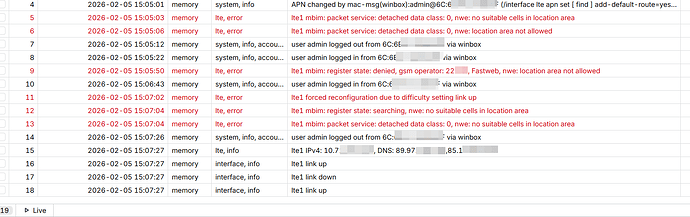

Hi everyone, I have important updates.
Please bear with me. I honestly don't understand much of what you are about to read. This explanation is entirely the result of an AI analysis that helped me troubleshoot the logs to find a solution. I understand very little of the technical details it gave me, but I am sharing them here to see if this logic makes sense to you experts and to see if this configuration will actually work.
1. The "PC Test" Before looking at the logs, I did a physical test. When I realized the router had no internet, I unplugged the ethernet cable from the ASUS WAN port and plugged it directly into my laptop. The internet worked immediately on the laptop. However, when plugging it back into the ASUS router, it still wouldn't work. This confirmed that the MikroTik ATL was actually online and working, but the ASUS router was somehow "stuck" and unable to navigate.
2. Log Analysis Findings (via AI) I managed to extract logs from both devices and the AI helped me reconstruct what happened.
From the ATL WinBox logs, we found these errors:
This confirms that at some point the LTE module lost registration with Fastweb (probably after a power outage on Jan 24th based on the router logs).
From the ASUS router logs, the AI reconstructed this timeline:
  • Jan 24, 08:27 — WAN link went down and never recovered.
  • Feb 6, 23:04 — When I arrived, the router got a DHCP lease (10.226.140.219/29 via 10.226.140.220) but the ping to the gateway failed immediately. WAN dropped again 4 minutes later.
  • Feb 7, 00:07 — I rebooted the router from the web interface.
  • Feb 7, 00:09 — After reboot, the router got a completely different IP and subnet (10.234.170.174/30 via 10.234.170.173), ping was successful, and internet was restored.
3. The Conclusion According to the analysis, the issue was a Subnet Mismatch. While the connection was unstable, the ISP changed the IP subnet (from .226 to .234). The MikroTik (in Passthrough) updated correctly, but my ASUS router kept trying to talk to the old Gateway IP because the physical link never dropped long enough to force a full DHCP DISCOVER.

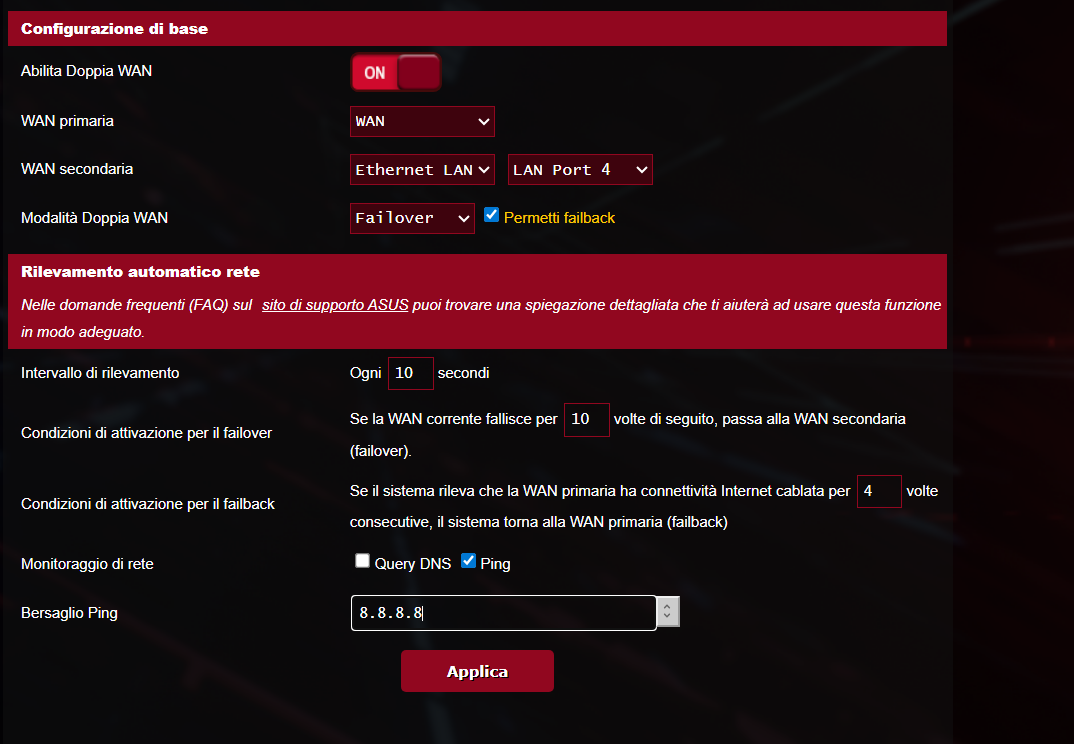

4. The Solution I Implemented To prevent this in the future, I configured a "Watchdog" on my ASUS GT-AX6000 using a Dual WAN workaround (to unlock the network monitoring reboot feature):
  • Dual WAN: Enabled (Failover Mode)
  • Primary WAN: WAN (Connected to ATL)
  • Secondary WAN: Ethernet 4 (I selected this LAN port but left it empty/disconnected, just to act as a dummy interface).
  • Network Monitoring: Ping 8.8.8.8
  • Interval: 5 seconds
  • Trigger: If ping fails for 12 counts -> Failover/Reset WAN.
My Questions:
  1. Is this "Dual WAN" workaround a solid solution, or is there a "cleaner" way to force the router to refresh the DHCP Lease when the Passthrough subnet changes?
  2. WinBox Issue: While troubleshooting via Ethernet connected to the ATL, WinBox disconnects me every 10-15 seconds. Is this normal behavior for Passthrough mode? It seems like once the public IP is passed through, the management connection drops. Is there a way to fix this?
Thanks so much :grinning_face:
There's nothing wrong with your solution, given that it works reliably.
This is, by the way, why I dislike passthrough mode a bit. The LTE side has the capability to "push" addressing updates from the provider side, while the DHCP you device passes this configuration on with doesn't really have a comparable feature, at least it's not really implemented.
Two alternative solutions:
  • You could force the link down in case of an address change via a script.
  • You could use a routed setup and give your ASUS router a private network and gateway, with DMZ-like forwarding of all externally initiated traffic to it. This usually works fine for all protocols, except for IPSec where some software may have certain difficulties.
  1. if it works, it works. :slightly_smiling_face: There is nothing wrong with it that I can see, at least if/until you need to use your Asus ether4.
