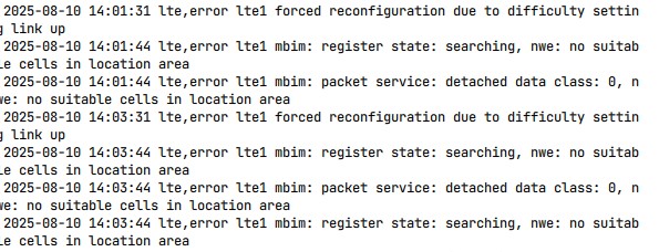

My T-Mobile eSIM card can't connect to the internet. I did everything according to the instructions in the Mikrotik video. The eSIM is activated, the PIN is disabled, and yet the internet doesn't work. Please help.

I also have the same problem.

For sure there is an issue either from Mikrotik or T-Mobile as I have also simillar problems with activations. Sometimes the eSIM works, sometimes not (since 2 weeks it is not working at all with Mikrotik).
What is more important I have no issues with T-Mobile eSIMs once installed on Teltonika devices. What is interesting the service that is working on Teltonika (eSIM) after installing on ATL (new esim generated) is not working.
