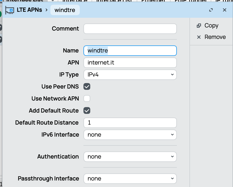

I purchased a 5g mikrotik ATLGM router that I use with sim wind unfortunately never connects to 5G giving me error "lte1 mbim: register state: denied, gsm operator: 22288, WINDTRE, nwe: missing or unknown APN" can anyone help me? let me start by saying that the SIM works correctly and in the same place it worked very well with the zyxell antenna. The APN is correct internet.it jast checked with the operatore WIND/3.

Check in detail your settings, they are somehow confusing, you need to BOTH add the APN manually AND set correctly the use network apn setting to no.
See:
Thank you very much for your suggestion, i just have a network apn uncheck
Ivan
Your settings seem correct, unless you have some strange white space characters, the APN seems the right one, and the Use Network APN unchecked is the same as "use-network-apn=no", I would still check the command line, open terminal and in it type:
/interface lte apn export [ENTER]
Try rebooting the router, first, to make sure that the setting has "taken", there is not much else to try.
Which RouterOS version are you running?
I presume that the same SIM has been already tested on a phone or other device and it works.

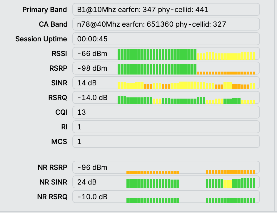

The issues started appearing straight after the modem completed the fw upgrade. It happens only with this APN; I suspect because it was active by the time of the upgrade.
Following the upgrade, the APN carries on works however the connection speed drooped as the modem started switching to cells with poor RSRP, SINR & RSSI metrics; before it was locking in to the stronger cell tower (see image below)
I have a feeling the LTE fw upgrade wasn’t clean
I am looking for a way to a) either reflush the latest or b) go back to RG520FEUEAR03A04M4GX_01.300.01.300, but I haven’t figured this out yet.
