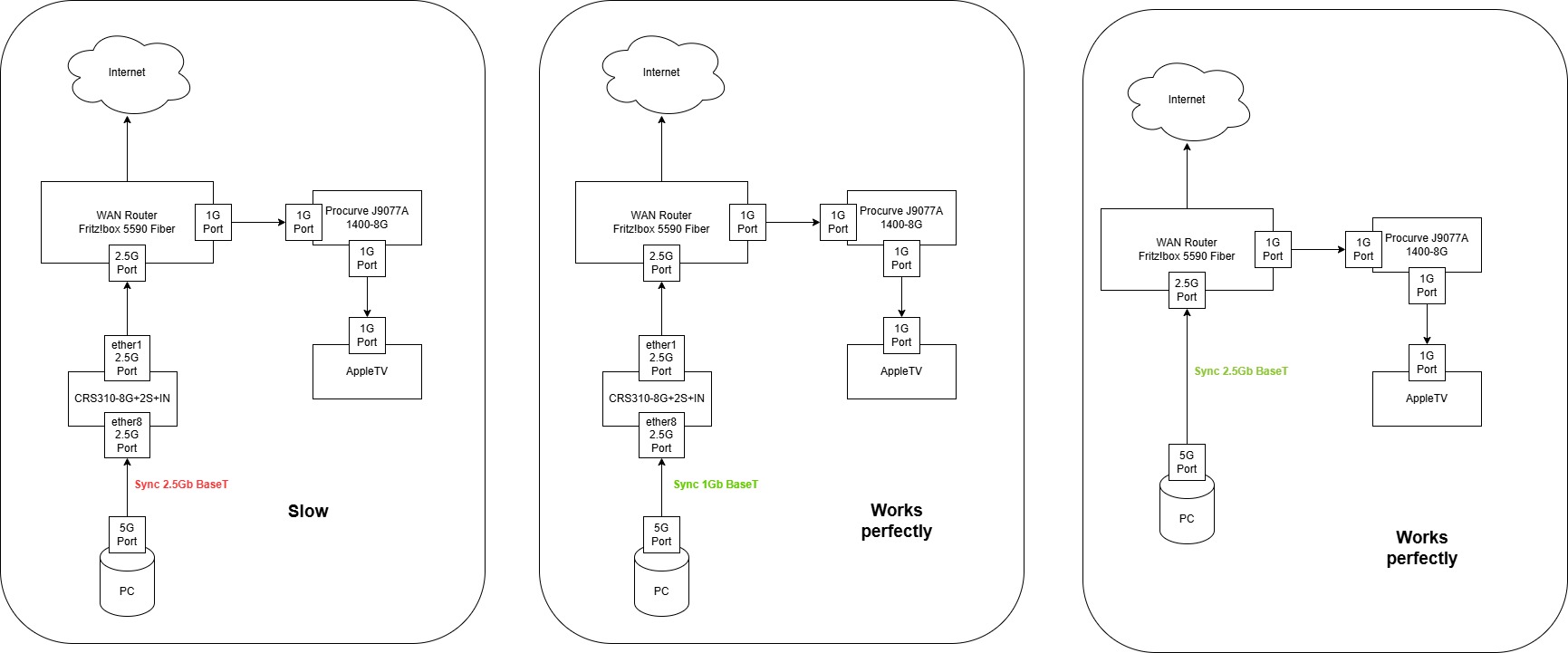

I’ve attached a diagram illustrating three topology scenarios:
  • When my PC syncs with the CRS310 at 2.5G, game streaming to the Apple TV is slow.
  • When my PC syncs with the CRS310 at 1G, game streaming to the Apple TV works fine.
  • When I bypass the CRS310 and sync my PC with the Fritz!Box at 2.5G, game streaming to the Apple TV is perfect.
My concern isn’t that my PC can’t maintain a 2.5G connection with the CRS310 for game streaming (I only use this setup for scenarios requiring high bandwidth and extremely low latency); rather, I suspect there’s an issue with syncing the PC at 2.5G with the CRS310 compared to using the Fritz!Box.
Interesting so you have a fritzbox device that is NOT providing anything other than one flat subnet. No vlan capability, no port forwarding capability? No real firewall rules to speak of.
Assuming its fiber cable IN and using 2.5Ghz out for max throughput.
It would seem that you want to use the Mikrotik switch as a router, in which case the top speed you should expect with some firewall rules is about 300Mbps.
Stick a 5009 router in between with the 2.5gig to the Fritz and the 10+ to the switch and you would be in business.

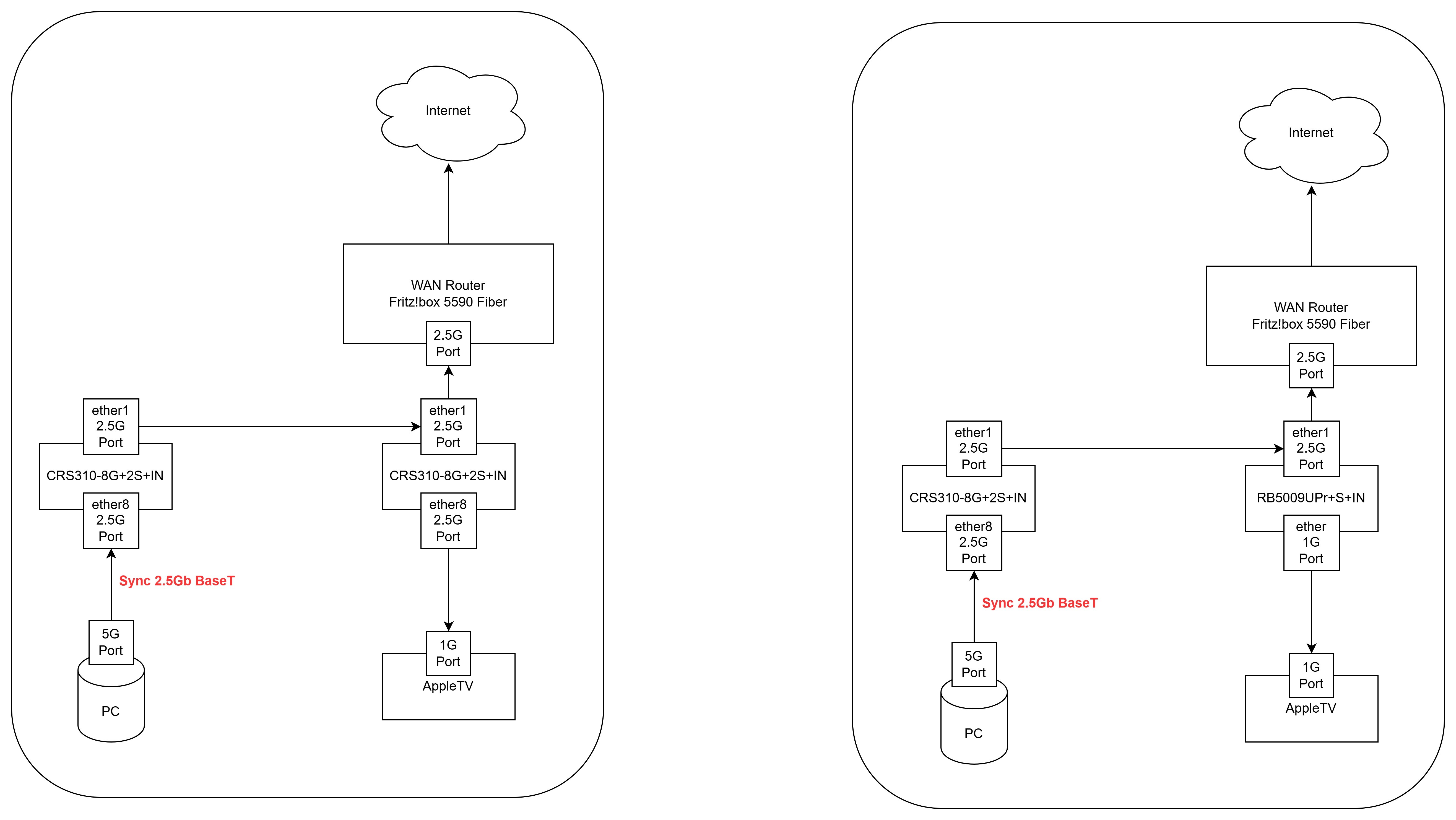

Yes, I have a plan to achieve that—potentially using another CRS310-8G+2S+IN or maybe the 5009 ( it only have one 2.5G port, not sure if will be future proof or maybe yes ) —but first, I need to confirm that the CRS310-8G+2S+IN is capable of handling the job.
If the plan is to use the CRS328 as a switch NO routing, no creation of VLANS on switch, then it will work ( one flat subnet from fritz ).
If you intend to have a network of vlans behind the fritz, then put a router after the fritz like the 5009 so at least you maximize the throughput of the system.

Maybe I’ll need to buy a MikroTik RB5009UG+S+IN or another CRS310-8G+2S+IN, but both have stock problems in my country ( Spain ), and also read some problems with 2.5G port on RB5009UG+S+IN and not sure if they’re resolved.
