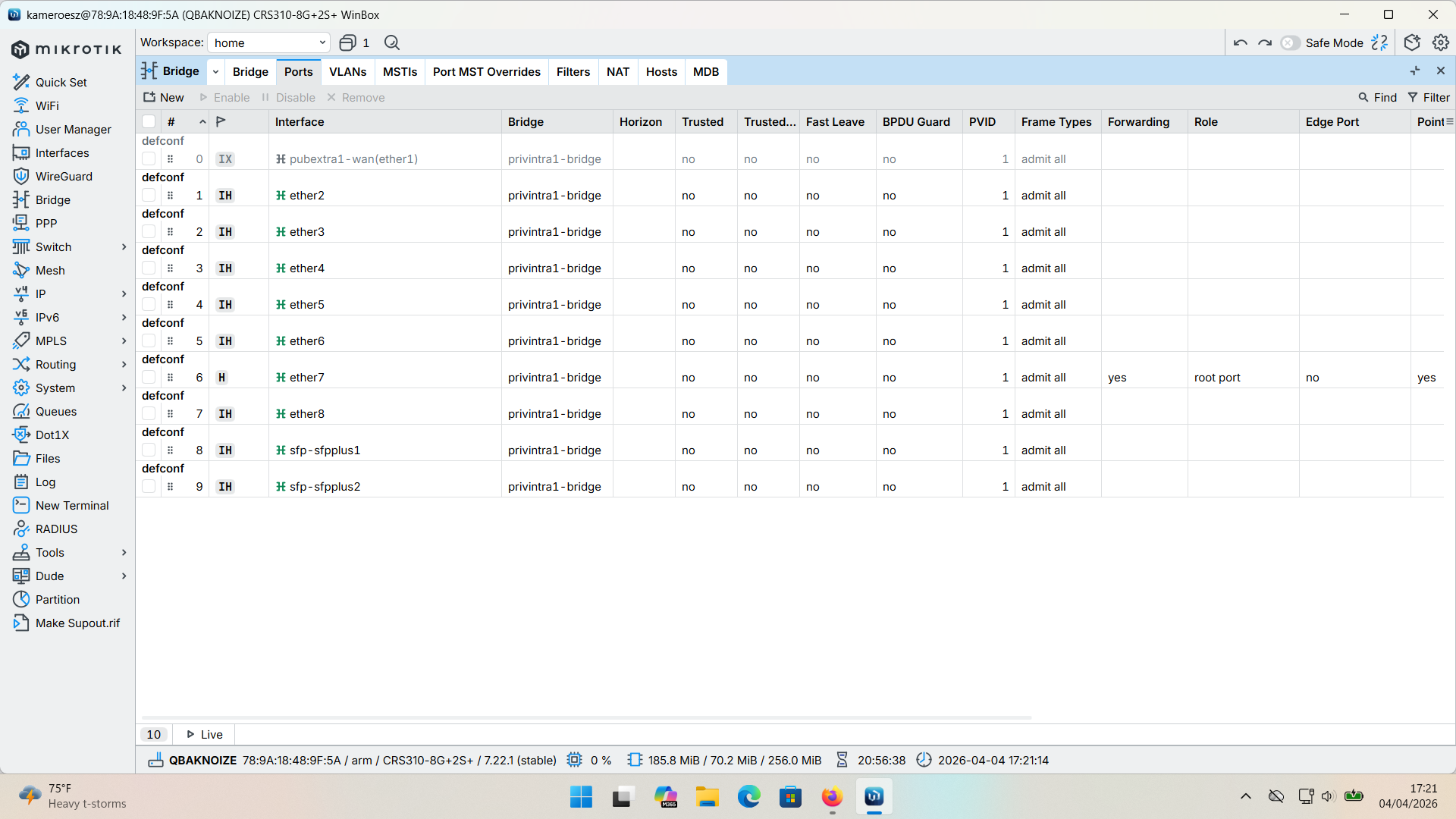

I thought l did setup the device correctly with the “quick set” as a router. I realized later apparent it wasn’t “complete”.
Found this on the internet {Mikrotik CRS310-8G+2S+IN Config · GitHub} and followed the steps per line using Winbox not CLI only. From line “22 - 30” for some unknown reason l can’t succeed. I can perform all task with winbox from line “3 - 20” and “32- 85”… l guess.
I believe I need that block line “22 - 30” to configure from line “86 - 142”. Any suggestions or guidance would be appreciated.

That github was probably assuming a "blank config".

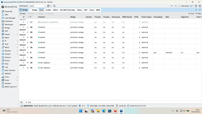

Are you sure there isn't alread a bridge defined that is using the ether ports?
Post sanitized config export you are starting from.

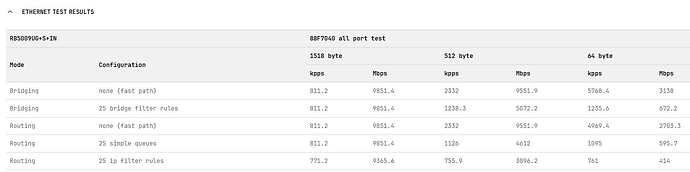

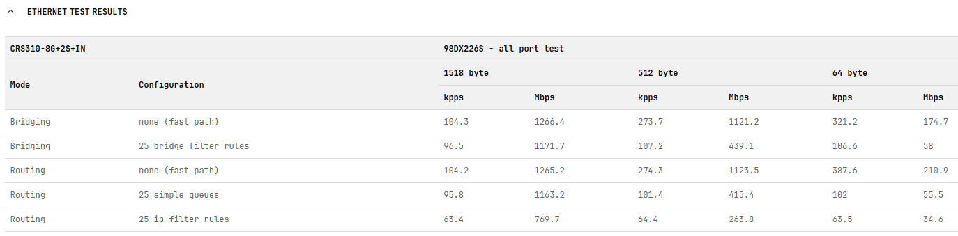

I think you are going to be disappointed with routing performance of the CRS310-8g+2s+, that's why the recommendation to look at the RB5009 in this thread
The RB5009 has over 10x the routing performance of the CRS310-8g+2s+ unless the L3HW "inter-vlan" routing is good enough for your "routing" needs. See Issues with l3-hw-offloading on CRS310-8G+2S+
For comparison of CRS "routing" performance see https://mikrotik.com/product/crs310_8g_2s_in#product_specification and look for Ethernet Test Results
and compare to RB5009 (which has a much better CPU and routing performance and a more limited switch (but still quite capable, just no L3HW in the switch chip).
https://mikrotik.com/product/rb5009ug_s_in#product_specification

Check what you have now.
Export your configuration and compare it to the github example.
Post it on the Forum for review.

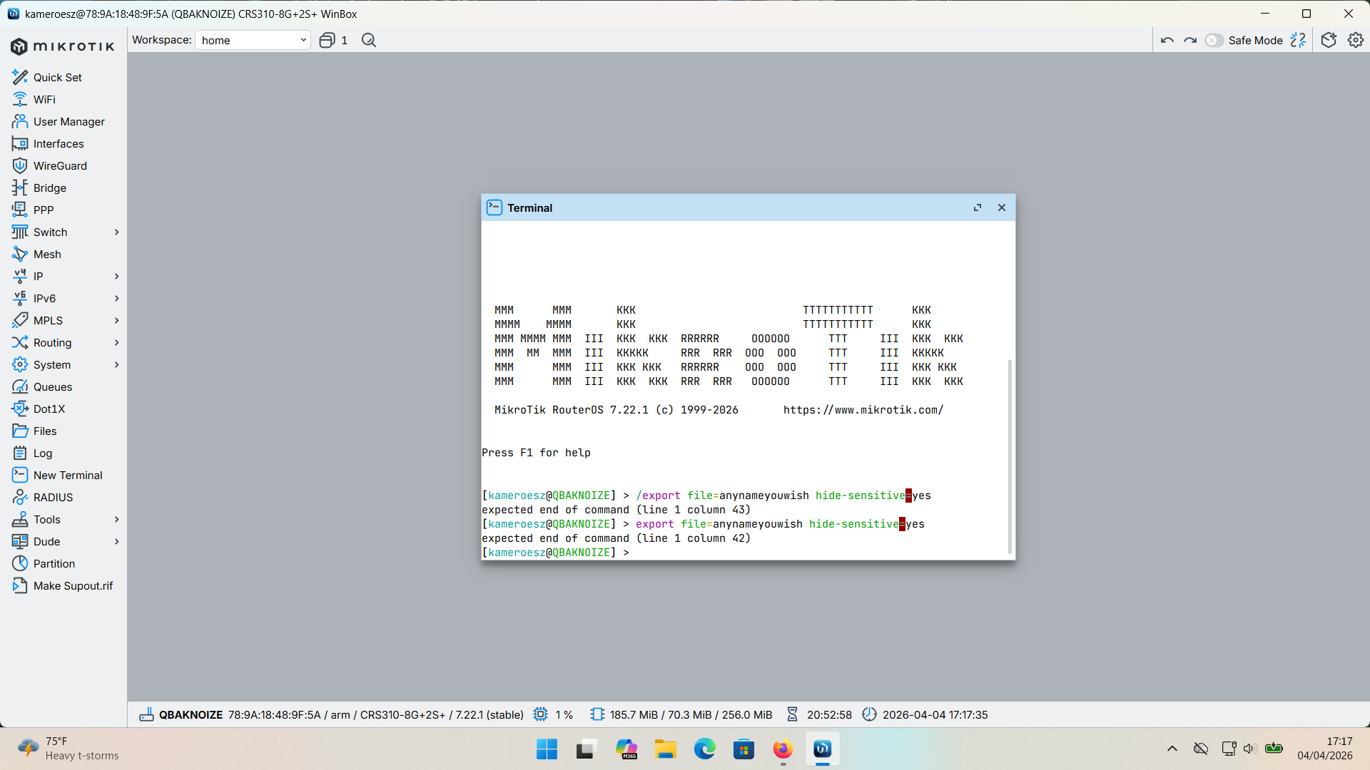

I’m having issues
The export in RouterOS V7 has hide sensitive active by default. Just perform export with only filename as argument.
as erlinden said, in V7 to export sensitive info now requires the use of show-sensitive.
The reason for the error message is that the correct syntax does not have a value associated with hide sensitive.
So
/export file=my_crs310
or
/export file=my_crs310 hide-sensitive
will both work, and both will create the same file (other than time of export)
the problem was the hide-sensitive=yes
[demo@RB760iGS v7.19.6] > /export file=anynameyouwish hide-sensitive=yes
expected end of command (line 1 column 43)
[demo@RB760iGS v7.19.6] > /export file=anynameyouwish1
That is what the link shows but it said for "V6". I don't have a V6 device around to test if that is a valid option on V6 or not. @gigabyte091 do you know if the =yes does work with V6? If it does not, can you edit the post (maybe add "for V7 do this" and "for V6 do this" in code blocks.

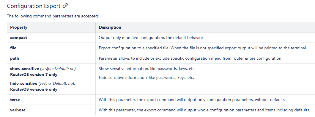

From Configuration Management - RouterOS - MikroTik Documentation
There are several errors here.
It at least implies that yes and no are acceptible values for hide-sensitive and show-sensitive. But
[demo@MikroTik] > export show-sensitive=yes
expected end of command (line 1 column 22)
# 2025-09-11 09:28:04 by RouterOS 7.19.6
# software id = *****
# model = RB760iGS
you can see that show-sensitive=yes is not accepted.
And the description of the options compact, terse, and verbose are misleading at least.
But the description of terse is just plain wrong.
This is a valid export command:
/export verbose terse
which will show all options but in "self contained" format.
So is
/export compact terse
and it is same as /export terse

Yes and no.
The change has been from this:
Property Description
show-sensitive (yes|no; Default: no). RouterOS version 7 only Show sensitive information, like passwords, keys, etc.
hide-sensitive (yes|no; Default: no). RouterOS version 6 only Hide sensitive information, like passwords, keys, etc.
to:
show-sensitive Show sensitive information, like passwords, keys, etc. By default, sensitive information is hidden.
A welcome change (in the future) would be to expand on this:
with a FULL, DETAILED, EXHAUSTIVE list[1] of what is considered "sensitive information".
