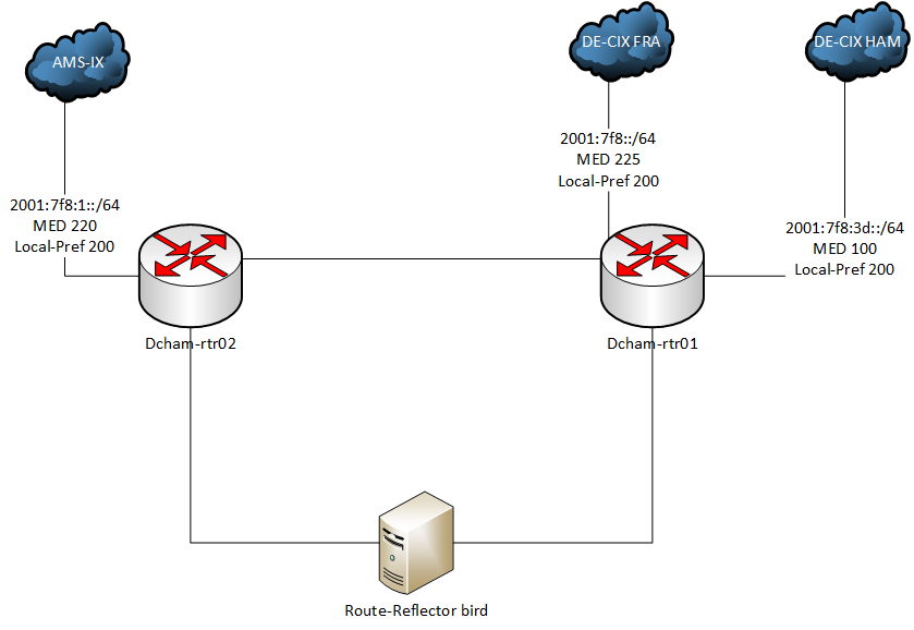

We are operating 5 CCR2004 with RouterOS 7 for our backbone and maintaining peering sessions at DE-CIX FRA, HAM, DUS, MUC and AMS-IX as well as to our upstream providers. Routes between those 5 routers are being exchanged via linux bird route reflectors in order to avoid full mesh bgp sessions.
Mostly this works as expected. Recently the CPU load on our routers skyrocketed and the BGP announcement traffic to our route reflector heavily increased for no reason. Further investigation revealed a route announcement loop. Our router DCHAM-RTR01 startet playing announcement ping pong with DCHAM-RTR02. We simplyfied our network diagram down to the relevant hosts. We analyzed bgp announcements via wireshark and found that the follwing announcements were alternating in a less than second rhythm:

What is happening? We are having three announcements (one is doubled because of two route reflectors distributing them) for the same destination. All three announcements have the same local-pref (200) and the same AS-path-length (3) but MED and differs. BGP path selection rule says: Take the route with lowest MED.
  1. DCHAM-RTR01 has 4 routes. Two via AMS-IX at DCHAM-RTR02 (immideate-gwxxx%bonding1) with med 220. One via DE-CIX-HAM with MED 100 (the correct active one). And one via DE-CIX-FRA with MED 225.
  2. DCHAM-RTR01 is publishing it’s active route to the route reflectors which are pushing them to DCHAM-RTR02.
  3. DCHAM-RTR02 is receiving the route with MED 100 via DCHAM-RTR01 and marks it as active because MED 100 is better than the MED 220 route via AMS-IX.
  4. DCHAM-RTR02 withdraws it’s announcent via AMS-IX with MED 220 from the route reflectors which are in turn withdrawing the two routes also from DCHAM-RTR01
  5. DCHAM-RTR01 has two routes left. One with MED 100 via DE-CIX-HAM. And one with MED 225 via DE-CIX-FRA. And now the error happens: DCHAM-RTR01 is marking the route with the higher MED (225) as active and pushes this route to the route reflectors replacing the MED 100 route.
  6. The MED 225 route is being pushed to DCHAM-RTR02 replacing the MED 100 route.
  7. DCHAM-RTR02 correctly sees that MED 200 route via AMS-IX is better than MED 225 route via DE-CIX-FRA and activates route via AMS-IX, pushing the route to the route reflectors.
  8. DCHAM-RTR01 get’s the MED 220 route via AMS-IX and now correctly activates the MED 100 route again, jumping back to step 1. The loop repeats.
It seems that for some weird reason in a special case the MED comparison is made wrong. It doesn’t make any sense why this is not happening all the time. And only when certain kind of routes are present. But this is what actually happens. We also ruled out any error being made by the route reflectors. Those are working as intended.
