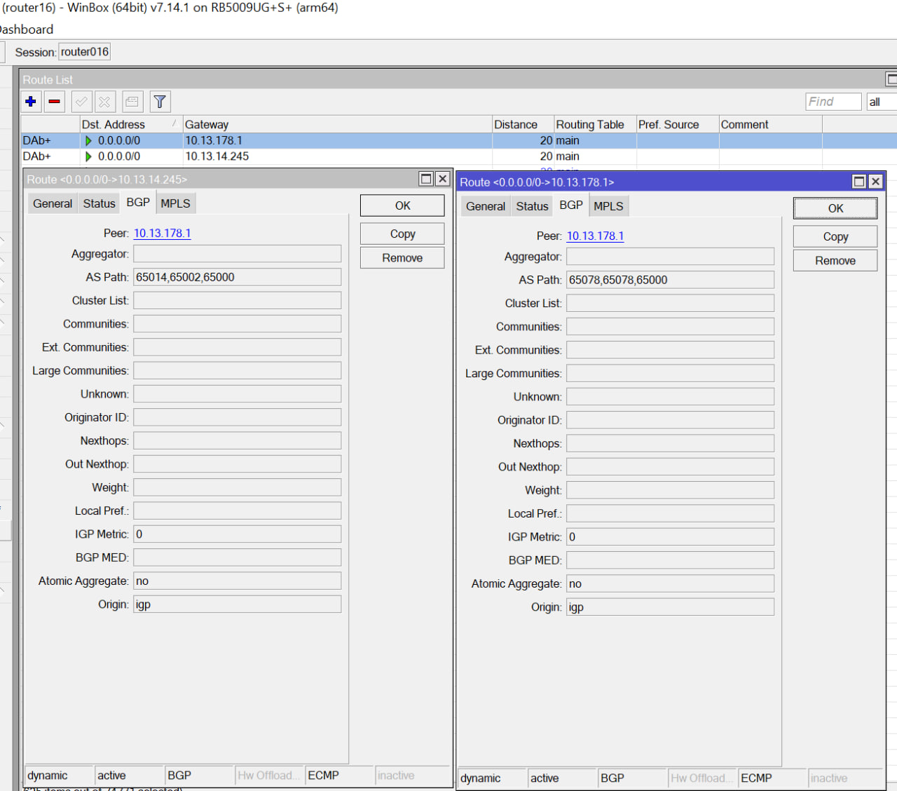

This happens when you have 2 or more BGP-Profiles.
Did you mean 2 separate BPG Instances (template?)
Yes. But i also got ECMP enabled for Routes with having only 1 BGP-Instance. Don’t know why, but that should not be possible due this feature is not implemented including v7.19.3. Had no time to check, why my routes were ECMP, but it should not.
