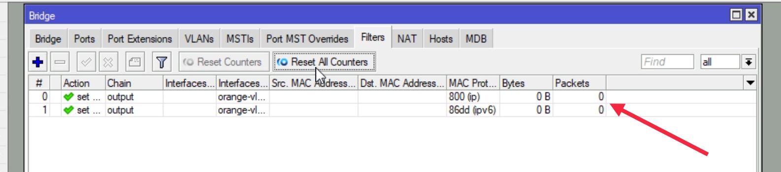

Bridge filter rules do not work on RouterOS 7.x (7.0betaX, 7.1betaX, 7.1rcX) with CCR2004-1G-12S+2XS
Bridge filter rules on VLAN seems to be ignored with all version of RouterOS 7.x on CCR2004-1G-12S+2XS.
This is particularly annoying because to my knowledge, it seems to be the only method to making DHCP requests working for Orange french ISP provider (set priority of 6 on UDP port 67 for VLAN 832). Bridge filters on same configuration works very well on RouterOS 6.48.x and 6.49.x.
Packets and Bytes remain to 0 (screenshot was made with 6.49.2 for illustration purpose, but the problem of 0 counters are for RouterOS >= 7.x).
NB : I even tried more generalistic rules without any criteria except
chain=output
and the result is the same : Packets and Bytes remains to 0.
Configuration

Well, indeed, i tested simple filter rules on stable 7.1 and they do not work when VLANs are used…
@support, do you have any workaround / roadmap to fix this ?

Fixed in 7.1.3 / 7.2rc4 !
*) bridge - fixed bridge filter and NAT rules on ARM64 and TILE devices;
