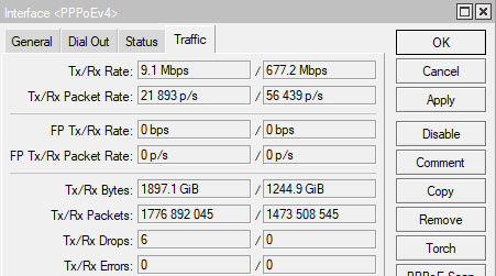

I’m pretty sure that both RB4011 and hAP ac2 had fasttrack working with bridge vlan filtering on, when running rOS 6.x and I could get 900+ Mbps (IPv4 w fasttrack, no bridge hw acceleration).

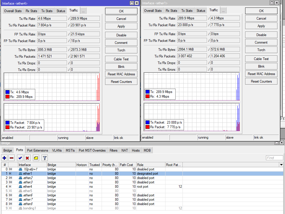

650-680 mbps is way to low for the RB4011.
How I’m supposed to configure a port in a particular vlan on RB5009 or RB4011 and still have usable performance?
Here is a testing that I’ve done that shows that even L2 traffic is not getting via fastpath on RB5009, both ports have the same vlan as untagged.

L2 traffic should get on fastpath. Moreover, in most cases, L2 traffic gets offloaded to the hardware (switch chip), which is capable of forwarding L2 traffic at wire-speed.
Inter-VLAN routing (L3) is the one that is not implemented on the fastpath yet.

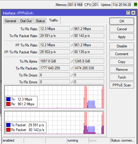

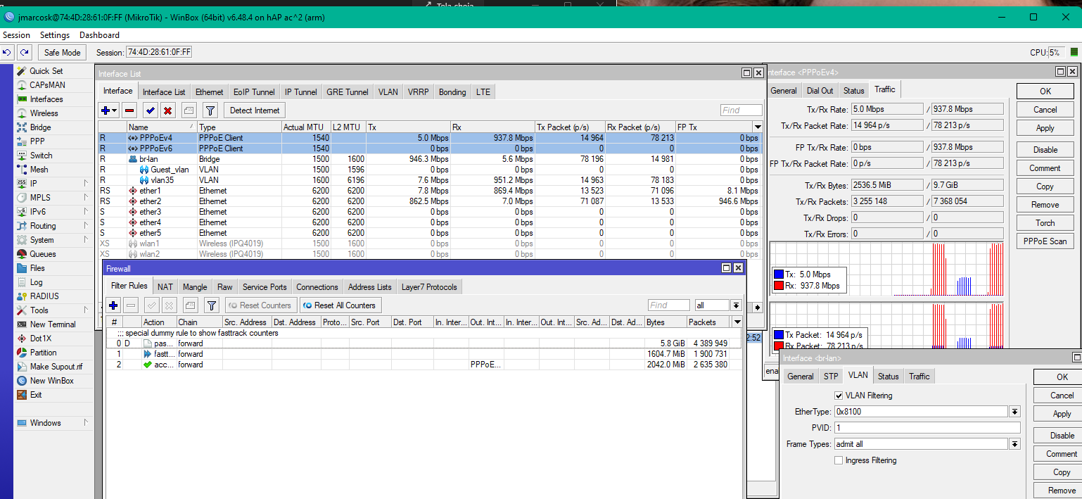

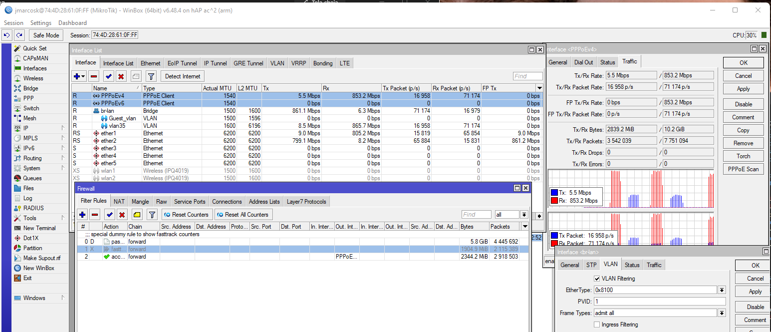

I just made a test with my hAP-ac2 running the latest stable rOS.
and fasttrack does work with bridge vlan filtering on, as you can see on the attached screenshots.
