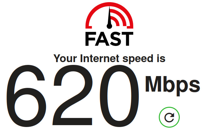

hello folks - I wanted to test mikrotik products and i ran accross the cap ax wireless ap. Pretty easy to install and certainly full of options once you get your way around it. I was pretty happy with it until i tested performance. For some reason both freqs 2.4 and 5 ghz are providing an extremely poor experience no higher than 80mbps in the best scenario.I played around with channels and all that but the number never seems to improve. So here is the question for those that are more experienced with mikrotik that are willing to give me some feedback:
  • Is this performance good for the product or I am screwing up the config somewhere?
  • I tried to look at the options to see if there was some sort of tcp or bridge option enabled that could be affecting overall performance but i couldn’t find anything.
  • In the same network I have another product that is able to reach around 450-500 gbps, when i looked in the mikrotik winbox scanner this device was showing as channel 5180/ax/Ceeeeeee. That doesn’t seem to be an option on the cap ax product, I configured the channel as 80+80Mhz 5180+5290
  • The biggest problem i see other than the speed is that wireless sessions just drop, on both frequences it seems the devices just randomly drops the clients. I have tried in multiple clients, linux, windows and macos devices. They all get randomly disconnected at times. Could this be a configuration option?

I can get close to or over 800 using tp-link ax20u as wireless adapter for laptop towards AX3 (same chip and resources as Cap ax)

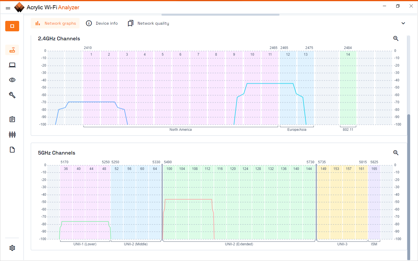

However, if that “other device” is already using channel 5180, why are you using the SAME channel ? That’s not smart.
Plan your frequencies so you stay AWAY from other access points already occupying certain channels. If that’s not possible, try to use the least occupied ones (usually better but not always).
good point, for some reason there were no available channel configured in the device and the antenna was down, I found this page and used it to do some testing: https://en.wikipedia.org/wiki/List_of_WLAN_channels#5_GHz_(802.11a/h/j/n/ac/ax) but the ultimate result was all the same, did not make a difference if i was using 5180 versus 5210, i even configured the secondary frequency to try and do 80+80 but my tests always showed the same result.I finally set to try and mirror the other AP to see if i could match the speed.

I have very pour performance with hap ax2 as APs connected to RB5009 via capsman. When downloading large files to my iPad from my NAS I get about 6-7 MBps while I get twice as much connecting through 5 year old Asus router. All devices in direct view to each other. The same slow speeds are obvious compared to Asus”s when using Samsung SmartTV on 2.4. Version 7.9.
Well then all other vendors are breaking regulatory (ASUS,DLINK,HUAWEI,ARUBA,entire ISP routers in my country )etc, or there is something broken with regulatory on mikrotik
If you take cheapest asus ax router it costs exactly HALF price then cap ax and i get almost double range or speed then any mikrotik ax wireless.
Only setting mikrotik to no country(max power) gives about same speeds/range as other vendors.

Here are my 5G WiFi tests near and far. I have a big thick chimney in the way where I am testing from so I’ll also add the the signals for context.
Testing from hAP ax2 and cAP ax to a btest server running on windows11 using ax210 Intel WiFi Card.
So mulitithread 10 streams gives 800/900Mbps and the far end on my range upstairs cAP ax gives me 200/250Mbps
