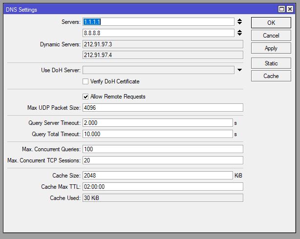

on LHGR v6.49 - this works

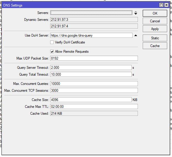

on Chateau 5G v7.1rc6 - only DOH works

Are you sure the DNS from your ISP provider work? The LHG specifies public 1.1.1.1 and 8.8.8.8 as a DNS servers, while the Chateau does not – so they don’t appear to be “the same config”. Basically, the screenshots show
isn’t quite true.
To prove this, you might want to remove the 1.1.1.1 and 8.8.8.8 from the LHG, and I suspect it also won’t work for DNS if all else is really “the same”.
Since I’d imagine your ISP DNS servers do actually work, you may want to look at your firewall/NAT config since it could be the ISP ones are getting block or not NAT’ed, somehow.

But in your photo of the DNS configuration, it shows the LHG having a DNS servers of 1.1.1.1 and 8.8.8.8 – that the difference. If you add those to the Chateau, like on your LHG, you should be set.
RouterOS will use manually configured DNS servers over the dynamic ones. If you look at Tools>Torch on the LHG out the wan interface, you’d like see port 53 traffic going to either 1.1.1.1 or 8.8.8.8, not the ISP DNS that the Chateau is using.

if i put in Chateau 8.8.8.8 and 1.1.1.1 it wont work at all. That was the purpose of those picutres to point to that.
Chateau doesnt work with custom DNS servers or ISP ones!! It only works with DOH server and that is also not stable.

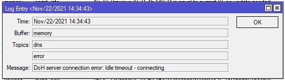

Sometimes it has timeouts like on next photo…
On the DHCP client you can disable the “Use Peer DNS”. Then the dynamic DNS servers won’t be shown (neither will they be used) in the /ip dns settings.

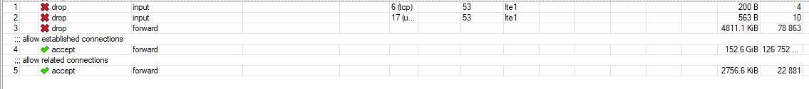

/ip firewall export
@kresozg…is that your complete firewall? I think it is not really safe…

e.g. it appears you’re dropping DNS on “input” before accepting related connection. Since the router is doing the lookup, the return DNS response is seemingly getting dropped. If you move those rules below the “accept” using “related” flag, that might fix your issue.

On why DoH is flaky, assuming this is using LTE, I’d setting up a Tools>Netwatch to ping 8.8.8.8 or 1.1.1.1 every second or few. If the LTE interface or underlying cell network was slow/not responding, that also could be why you see the DoH error. DNS happens a lot, so if the internet has congestion, DNS be first to fail and you won’t get to next operation. e.g. maybe DoH timeout being an indicator of some congestion else where?
NOW, since v7.1 is new/under development, as is DoH, it also could very well be a bug – but might want to eliminate that the timeout may isn’t on the LTE or cellular network side.
