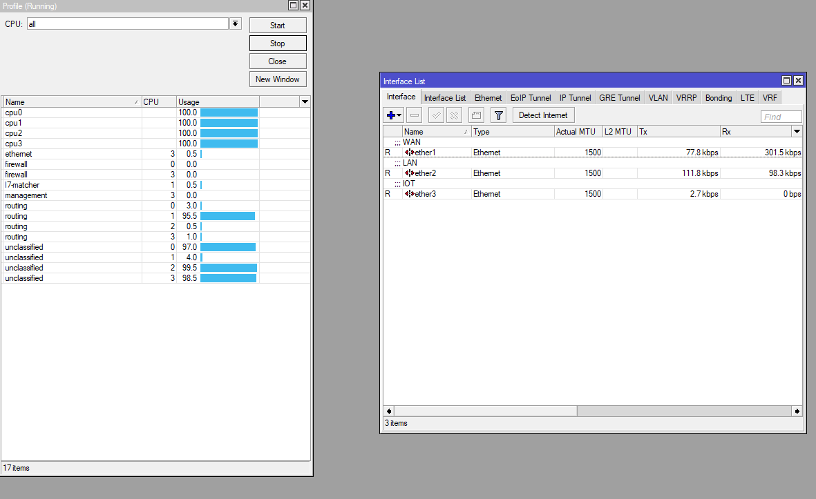

This is still not fixed in 7.0 Beta 4. I re-enabled the SSH 3 stage firewall rules and again after a few minutes the CPU usage spikes. Just to be clear there is no attack happening on my router just normal port 22 stuff that I am sure everyone sees when that is exposed. I disabled the SSH rules again and re-booted and the CPU is fine. The process that is pegging the CPU is the routing process. The only way to fix it is a reboot. It moves from core to core but same issue of one core pegged at 100% Also there is less than 1Mbps of traffic going through my router right now and the issue persists.
Here is a snip of the profile tool with my current inbound and outbound traffic. As I stated previously the only way to fix this is a reboot.
This is still not fixed in 7.0 Beta 5. This worked fine for years on 6.x firmware.
